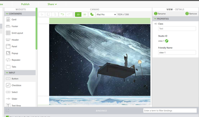

I have encountered two problems.
The first problem is: In the 2D canvas, I can only put down 4 images and the remaining two images cannot fit in the canvas. How can I put all the pictures into the 2D canvas?
The second question is: I created two buttons and gave them the same function($scope.nextImage), but only NextImage2 can call the function properly. Why can't NextImage1 call the function?
I uploaded my project file and hope someone can help me with this problem.

I would only place one image widget and change the source of it like this:
var currentImage = 0
$scope.nextImage = function (){
  currentImage++;
switch(currentImage){
  case 0:
    $scope.view.wdg['image-1'].imgsrc="app/resources/Uploaded/v2-85586d9840e6267231a4a4381a3face8_hd.jpg";
    break;
  case 1:
    $scope.view.wdg['image-1'].imgsrc="app/resources/Uploaded/v2-8bad62ab4301bbb336f25153c9698788_hd.jpg";
    break;
$scope.resetImage = function (){
  currentImage = 0;
For the second question it seems like you cant place the button in the headerButton widget. Outside of the widget the button works fine.
