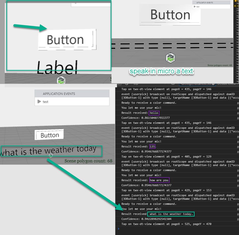

I checked it further but it seem that the one  option I mentioned is not availible on the HoloLens. So, it seems that we cannot input a spoken text
For example you can use some code  in a HoloLens project as it was described in the link https://developer.mozilla.org/en-US/docs/Web/API/SpeechRecognition
This will work perfectly in browser but it will not work on HoloLens because seems that  the speech recognition is something which requires a device specific API.
So for example when I tested   in preview mode:
Tested on HoloLens but it did not work.
