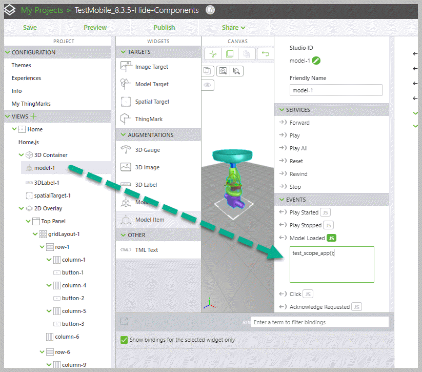

Hi @Isma,
one possible way to explore here e.g. $scope.app -you can use the following code:
$scope.test_scope_app=function () {
console.log("explore here $scope.app")
console.warn($scope.app)  }
Then add it to the model loaded event :

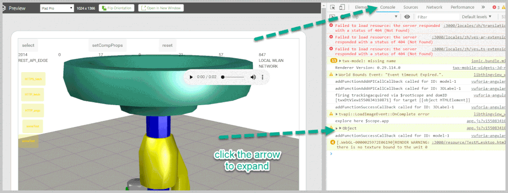

Then start the project in Preview mode and click Strg-Shift-I to start the chrome debugging mode.

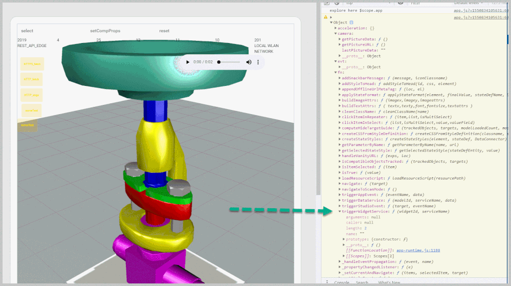

In the console tab you will find the warning print of $scope.app
2019-02-22_12-16-40.gifAfterwords you can explore by clicking the arrow (triangles) to expand the objects:
