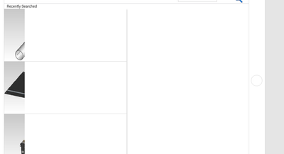

I have mapped and able to view data in repeater widget. PFB PNG for your reference
Currently data are filling from top to bottom. I'm looking for way to fill data from left to right and remaining data in bottom like Thingworx Collection widget and Repeater widget.

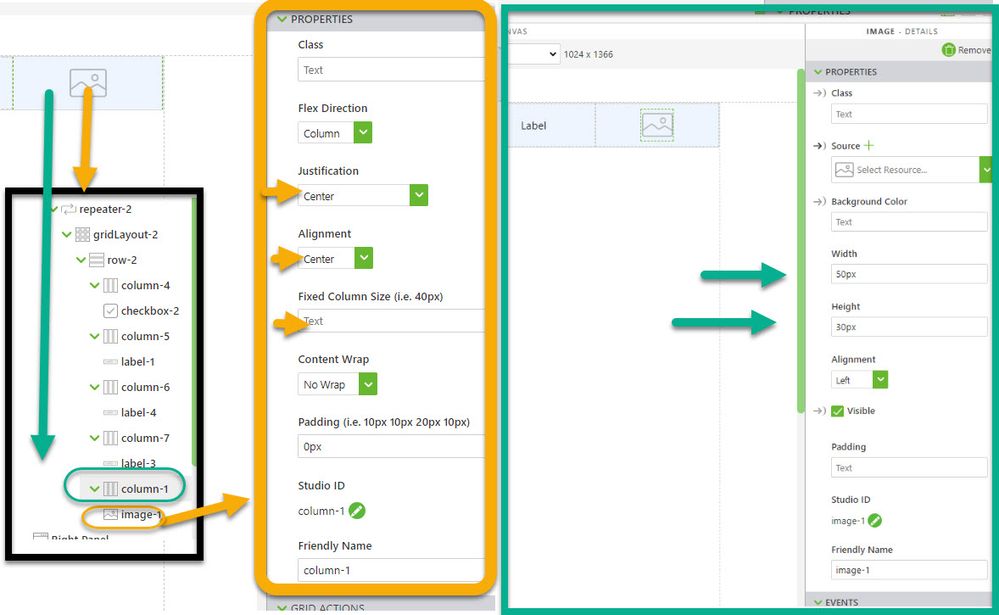

So when I correctly understand the problem - there is the problem that the picuture has not the correct size and are shown only partially? Right?
My impression is that here the problem is the format of the image widget. So to fix it you can set the property of the column and the widget image
but I see also you mentioned the order the data is written to the repeater? so you need the to write from left to right and from bottom to top.
I think , here you can try with the repeter widget properties:
Sorry maybe I didn't state problem properly.
Currently in Repeater data are filling from top to bottom direction, PFB PNG
I want that to be filled/aligned from Left to Right Direction

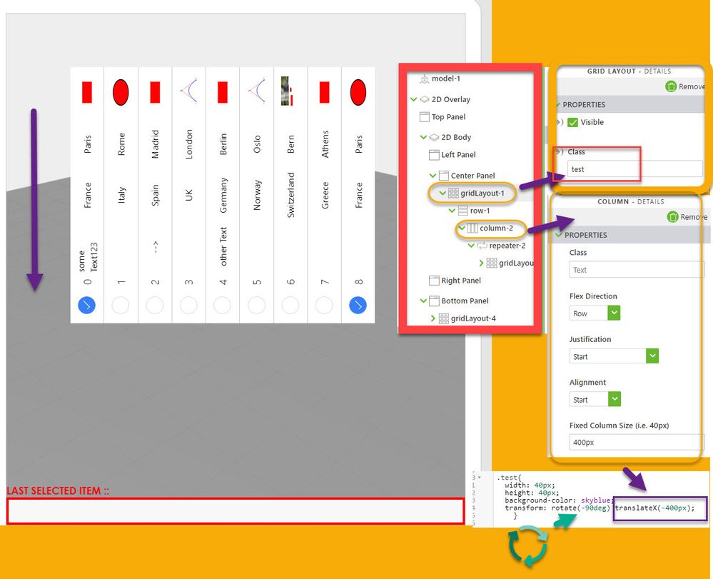

it seems that we can not achieve this only with property settings but possibly in combination with css style definitions - e.g. in the Applicaiton tab:
.test{
width: 40px;
height: 40px;
background-color: skyblue;
transform: rotate(-90deg) translateX(-400px);
And we can set the test to the gridLayout which contain the repeater (will rotate and translate it) . The best value could be found after some tests.
For quick test I did have the following appearance:
Of course, you can use some rotation also in sub elements e.g. repeater cells - for example you can rotate back the text again 90 degree if you want to have a horizontal texts but it will definitely require a number of tests when you want to achieve the desired appearance of your layout.
