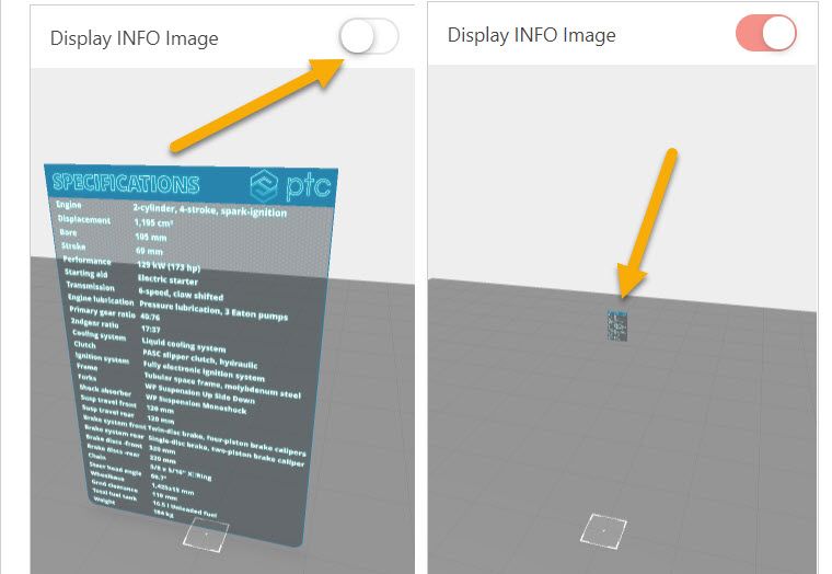

How to scale in and scale out 3D images on triggering visible function
Ace_Rothstein
8-Gravel
 Is it done by Javascript or can CSS animations be applied to 3D images
Hi @Ace_Rothstein ,
I review the video link what you mentioned in your post. Unfortunately I do not know exactly how it was exactly implemented  here  , but I think this effect could be done by moving the 3dImage widget e.g. in Z direction and scaling the 3dImage at the same. time.
I did test it in a simple project, and I think it works.
So have only 2 widgets 3DImage-1 Widget and toggle-1 Widget. So, I used the click event of the toggle to FlyIn and FlyOut effect. It is not perfect but works.
I used the following code:

I attached also the test project
