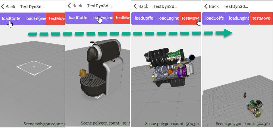

Hi @ppandarkar-2 ,
tested this example and it works fine /   in preview and IOS where I tested it/
So following 3D view with 3 buttons, one 3d Container and one space target (but also with thingmark should work)
Then defined the following code
// in TestDyn3dModel.js
var object3DNames=[];
$scope.app.testCoffe= function() {
 tml3dRenderer.addPVS('tracker1', 'model-coffe', 'app/resources/Uploaded/Coffee Maker Model_High.pvz', undefined, undefined, () => {
   object3DNames.push('model-coffe')
console.log(`tml3dRenderer.addPVS:: added new model`);
}, (err) => {
console.log(`tml3dRenderer.addPVS:: failed to add new model: ${JSON.stringify(err)}`);
$scope.app.testEngine= function() {
tml3dRenderer.addPVS('tracker1', 'model-engine', 'app/resources/Uploaded/engine_test_exp-div-speed.pvz', undefined, undefined, () => {
  object3DNames.push('model-engine')
}, (err) => {
//some tests
$scope.Test3DObjects = function (){
   let count =0;
   if(object3DNames.length>0) {
    for(var i=0; i<object3DNames.length; i++) {
       if( isPreview())
       tml3dRenderer.GetObject(object3DNames[i]).GetWidget().SetPosition(parseFloat(1.1*(i+0.2)),0.0,0.0);
       tml3dRenderer.GetObject(object3DNames[i]).GetWidget().SetOrientation(0.0,parseFloat(45.0*(i+1)),0.0);
       else {
        try{ tml3dRenderer.setTranslation(object3DNames[i].trim(),1.0*(i+0.2),0.0,0.0);} catch(e){if(DEBUG)console.error(e)}
        try{ tml3dRenderer.setRotation(object3DNames[i].trim(),0.0,45.0*(i+1),0.0);} catch(e){if(DEBUG)console.error(e)}
      $scope.$applyAsync()
 isPreview = function() {
    if(window.twx.app.isPreview()) // is in Preview
         return true;
   return false; }
isIOS=function() {
    if(!window.twx.app.isPreview()) // is not in Preview
       if(ionic.Platform.isIOS()) //and is NOT called on IOS = means Android mode detected
         return true;
   return false; }
 isAndroid=function() {
      if(/android/i.test(navigator.userAgent || navigator.vendor || window.opera) ) // is Android
         return true;
   return false; }
and tested in preview so was working fine , no problem:
