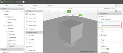

Ah, I think I see the problem. The target URL for the hyperlink doesn't go in the Click Event JS box, it goes in the URL field above:
I just did a quick test and it worked fine for me.

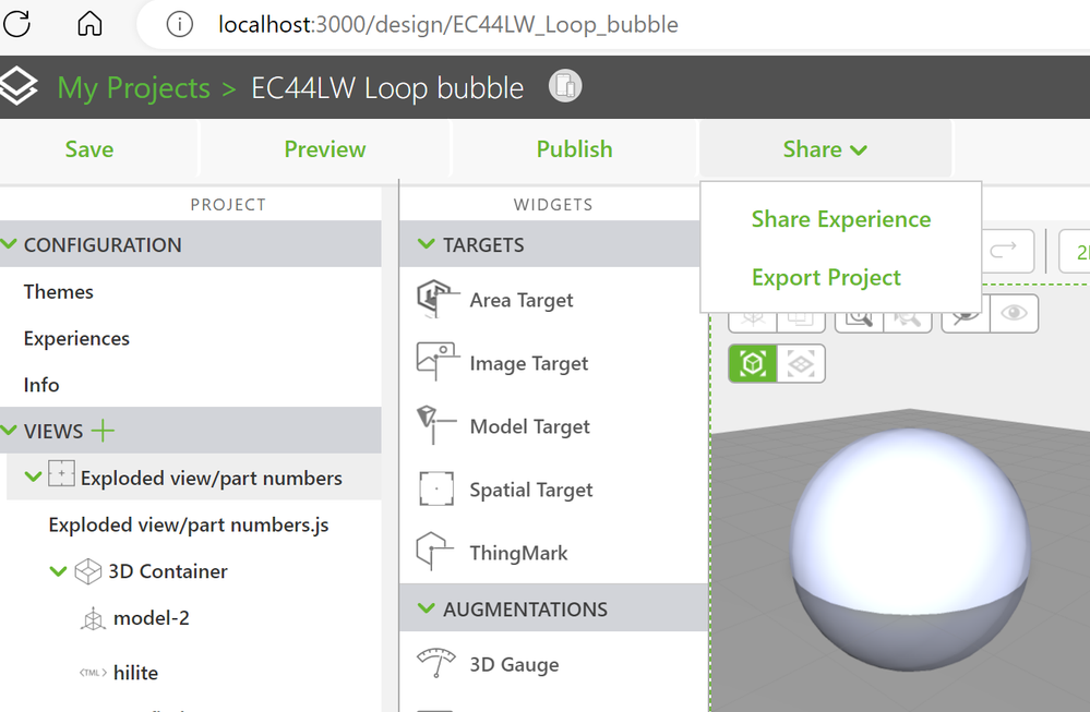

So, I go to the Share pull down to select the link:

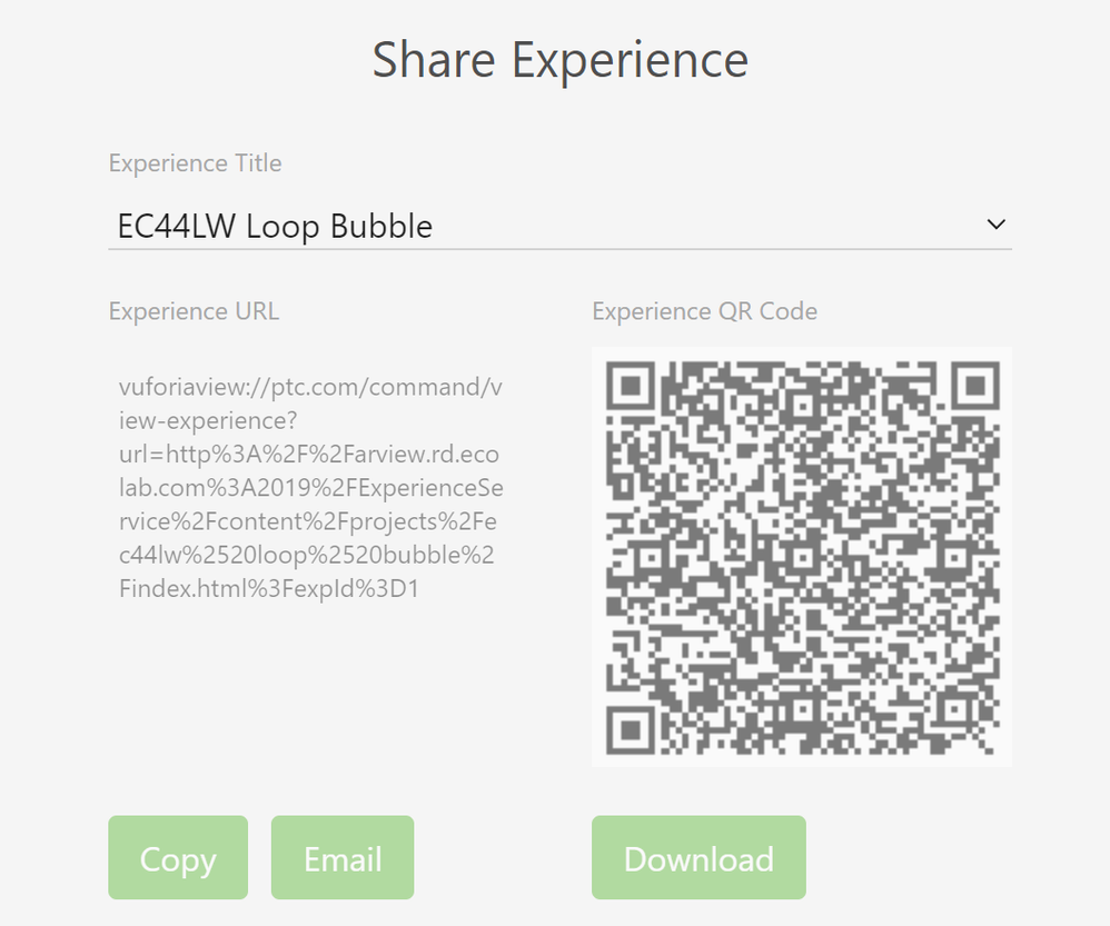

Grab the Experience URL:

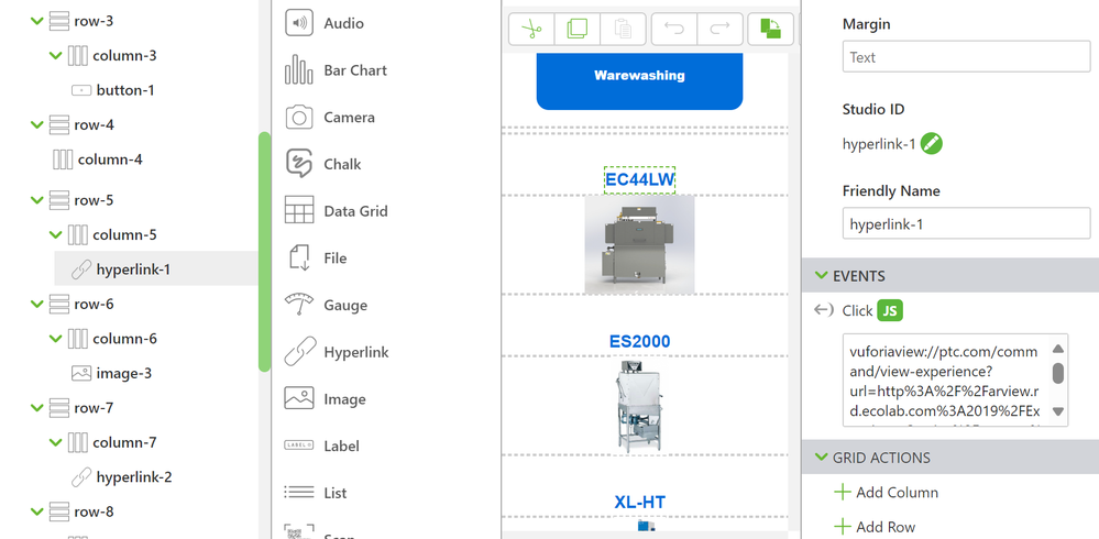

And put the link in the JS for the Hyperlink-1:
Thanks for your solution!  It worked for me too...
Glad to hear it!
