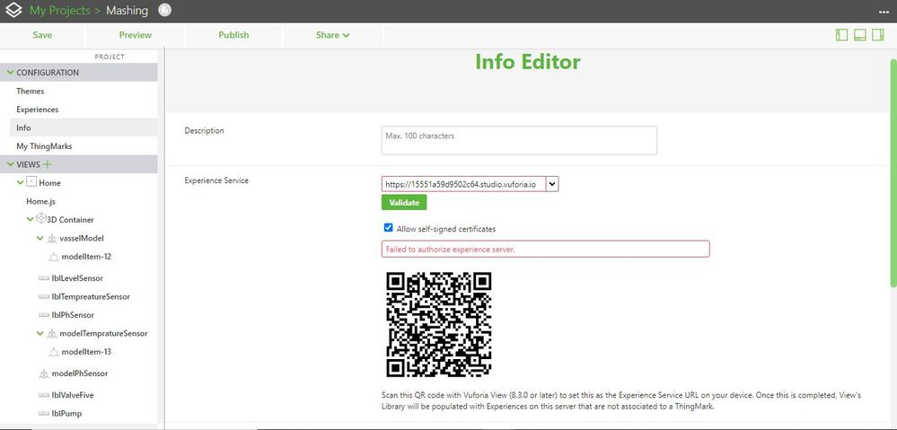

I am unable to validate my experience url for publishing my project .Please help me with a solution.

There was a similar error before:
Hi @SD_10252255,
Make sure the ES server is up and running.
You can check that by pinging ES server from Browser by accessing below URL.
http(s)://ES URL:port/ExperienceService/ping
If your computer is configured proxy, make sure to configure the proxy server info in Studio > Settings
