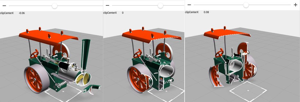

Hi @Aditya1702 ,
regarding your question for the planer shader according to https://support.ptc.com/help/vuforia/studio/en/#page/Studio_Help_Center%2FModelShaders.html
-> required is the center of the cut plane and a normal vector which defines the direction /normal to the cut plane.
Example of  js code which will set at begin the shader and then on change of the slider will move the position of the plane e.g along x:
$scope.init = function() {
  $scope.app.planarCutModel=$scope.view.wdg['model-1'];
  $scope.app.planar_cut_str = 'planar_cut; clipCenterX f '+$scope.app.params.clipCenterX+
                                                          '; clipCenterY f ' +$scope.app.params.clipCenterY+
                                                          '; clipCenterZ f ' +$scope.app.params.clipCenterZ+
                                                          '; clipAxisX f '+$scope.app.params.clipAxisX+
    													  '; clipAxisY f '+$scope.app.params.clipAxisY+
    													  '; clipAxisZ f '+$scope.app.params.clipAxisZ+
    													  '; clipLineWidth f '+$scope.app.params.clipLineWidth+';';
  $scope.app.planarCutModel.shader =  $scope.app.planar_cut_str;
  $scope.$applyAsync();
angular.element(window.document.body).ready($scope.init);
$scope.app.updateShaders=()=>{
here I used parameter which I could bind to the widget value - e.g. the clipCenerX with the slider 2d widget. There to fit the value some filter in the slider binding like that:
So the clipLineWith is the with of the white clipLine
So far I know it does not require UV mapping. Mostly shaders which use a texture will require such UV mapping to map the texture correctly . Here it calculates only the values of the cut surface.
sample project attached
