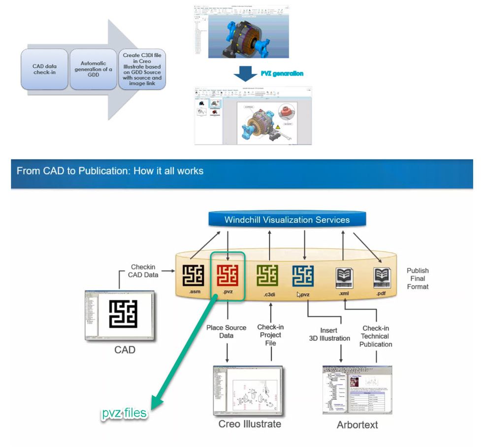

you can download data possibly directly from windchill or other server but that will not work because of CORS. So means that Vuforia View will not allow a call via different domains. so therefore the supported way is to use Windchill data --> to Thingworx repository --> Vuforia Studio
Here I want to refer to point 1.) of that post : https://community.ptc.com/t5/Vuforia-Studio/Is-there-a-way-to-load-3D-model-from-Thingworx-repository-to/td-p/961474
for the Integration  from  windchill to TWX - so the step is to export first from Windchill the  pvz files as export to folder  - as the part what is visualization /Windchill adapter could be seen in the article   https://www.ptc.com/en/support/article/CS112832
  1. In Windchill, if GDD is enabled, export pvz file generated by Creo View Adapters.

 I mentioned in the previous post the usage of customization to the addpater post-publishing process - therefore I  splitted it here into a separte post because it is other technique- possibly more easy to handle.. For that techniques you need that widndchill use visualization  where the cad model are visualized ito pvz internally - so in this case you could extract the pvz file via Visualization Rest API e.g. PTC.visualization.getPVZ()
Here is also an article
[Knowledge Hub] Windchill Visualization Services - Rest Services
which point to a hub - e.g. https://www.ptc.com/en/support/article/CS350641
with following points:
  • How to get the Representation ID in WRS?
  • How to download Representation as Zip (pvz file )?
