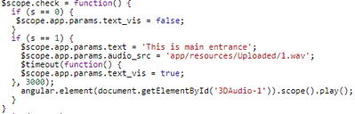

I have a problem with one of my new projects. I want to add audio which will be automatically played when I will click on a model with other stuff that will appear. But I don't know how can I invoke this function from 3D Audio widget. I always used this code to play animation in a model widget:
angular.element(document.getElementById('model-1')).scope().play();
I tried to change ('model-1')) to ('3DAudio-1')) but then Vuforia crash. Is there any different code to invoke this function from Home.js?

I want to create a simple guide in our office, for a new employees. They will follow a model of a robot, that will stop on each doors and preview text + audio. I've created a robot animation and a route in Creo Illustrate, every step in Sequence is a different department in our office (so every step should view different text and audio). I've created a count function which will add +1 to s value with every click on a model:
After that I have created a check function, which will check current s value and view audio file and text for every step with different time delay for a robot to get to the door:
The last function is a play and hide text function, when person will click a robot model to go to the next door:
All these functions are then set to "Click" event of model-1 widget:
When I uploaded Experience and viewed it on a Hololens, everything goes fine until I click on a model to go to the second step - Experience "freezes" and Vuforia View shut down. I've tried it couple of times, with different options and it is the same case every time.
Hi @Pawel_D. ,
one thing -  var s is global setting in Home.js but possibly not visible in the environment of the click button. So better to use
$scope.s  instead.
Another point is - try to call only one function in the JS UI. which will call all these code of the 3 routine.
Then you have to pay attention that the call is called asynchronously and possibly the order of call occurs  in different order aa indented. E.g. in check you check variable s but it is possibly not initialized  yet or not changed as expected
I think it is more recommended to use the JS event . E.g. to start the code for step e.g. on in the step one beginning (stepstarted) or step finishing event as suggested in the small example . Another option is to watch the change of variable or property e.g. in example the property current step of the model widget.

Hi @Pawel_D. ,
thanks for the feedback. Here I want to provide the sample project where this issue was tested. So hope , it could be helpful. Thanks! BR
Hi again @RolandRaytchev
Thank you very very much for help! Thanks to you my code is finally running. I changed some things in my Experience too, I hope I will not have any more troubles 🙂
