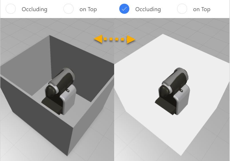

here / at least for me/is not clear what is the issue. I believe / not sure/ you want to occlude some geometry? Do you mean that some occluding effect is not working? Could you provide more details?
According to the help - Occluding: If set to true, the geometry of a widget is invisible, but at the same time hides any other augmentations behind it in the 3D scene.
Therefore, the background or camera feed appears where the occluded widget should be. This can be used to emphasize some augmentations by hiding surrounding 3D geometry.

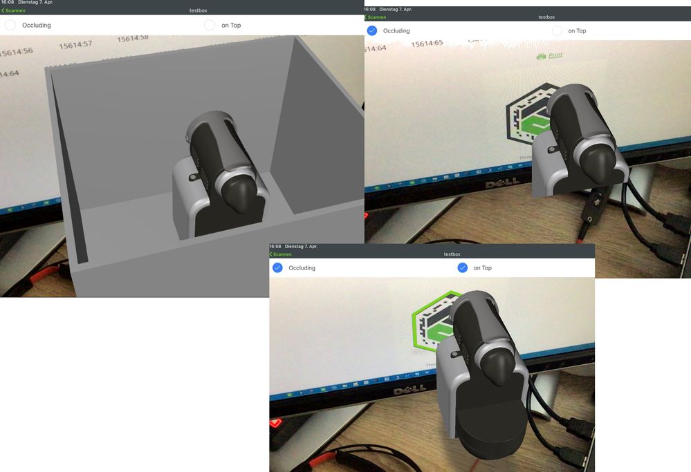

example In preview mode:
and then on IOS:

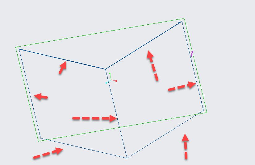

Another think is to try to user an partial model. Remove the cover but also the part and edges which are visible behind the model – means something of sloped  cut which will make all edges not visible. Some thing like this:
So that only these edges are visible and useable for the model target

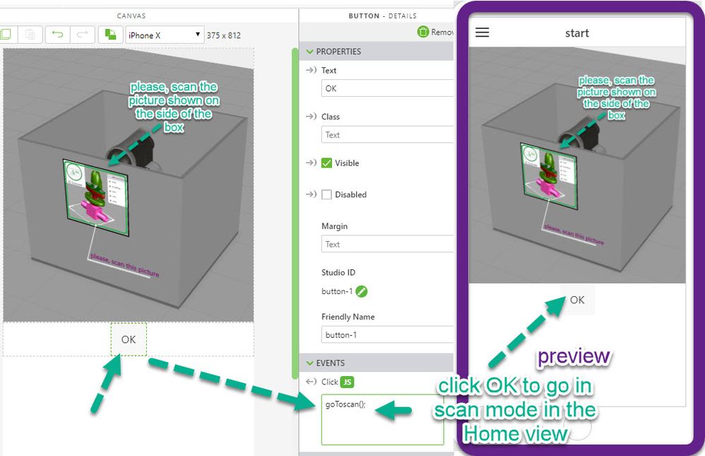

Hi @vincentdesign ,
I agree this could be a problem to know what you need to scan.

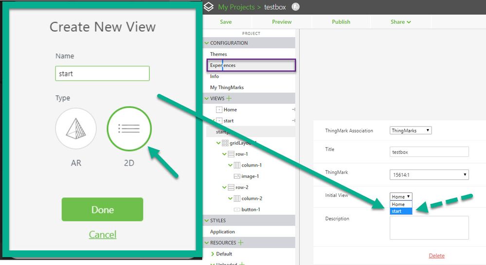

Therefore, I will suggest to use a help view. So, it means  to create a 2d view which is defined as initial view.
Now you can define in the start view  2 widget /
 a.)image which explains how to scan and
b.)ok button.
So, what I meant is:
- create a second 2d view e.g. start and make it as intial view - means when experience is started it will be displayed first
-in the "start" view add a Image widget displaying a picture which explains how to  scan / or where to scan
- define a button OK or "go to Scan" etc. which will call the Home view. Because in the Home view is an image target it goes automatical to scan model. So hope this could work for you. I tested on Android and it was working fine with a demo picture.
To navigate to the Home view you can define e.g. goToscan function:
$scope.goToscan= function(){
$scope.app.fn.navigate('Home');
