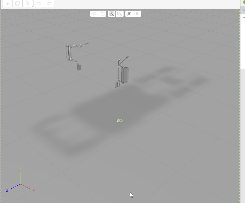

We are seeing that the main graphics area interface of Studio is now showing the colors as defined from Creo Illustrate after you select the sequence.  However, the issue we are having is that the graphics information in the user interface does not display unless you are performing an action like hovering the mouse over the graphics or spinning the model.  The image below shows the example...there is supposed to be the a-surface of an entire truck in the picture.  This is repeatable for two user's in our environment.
Anybody else seeing similar issues?

Thanks for the reply.  The geometry not showing in the graphics area is "on" and "off" meaning I can see the geometry if I'm performing an action.  If move the mouse curser, the geometry shows up...if I take my hands off the mouse and don't move the mouse, the geometry disappears.

So I was able to replicate this problem with one of our models, and can confirm that Studio is ignoring models/surface marked as "construction geometry". However I think this is all recipe file related. Here is what I have found:
  • I have a medium sized assembly in Creo.
    • If I export it from Creo as a .pvz with what I believe are the default/stock recipe file, surface models come out as normal models. You don't need to check the filter box in Creo View and they show up in Studio the same.
    • If I look at the visualization rep that our Windchill CAD worker creates all the surface models get flipped to Construction Geometry and you need to check the box in Creo View to see them and they do not show up in Studio.
So until a fix can get put into Studio (or they come back and say "works to specification") maybe exporting a .pvz out of Creo will get you what you need.
I'm going to investigate and see if i can find out what is in our CAD worker recipe that is causing this.
The recipe file setting causing issue this is: adapter/convQuiltAsDatum=1
Which is described as "convert Quilts to Construction Geometry". If you change or add a line for adapter/convQuiltAsDatum=0 quilts will not get converted and show up in Studio.
