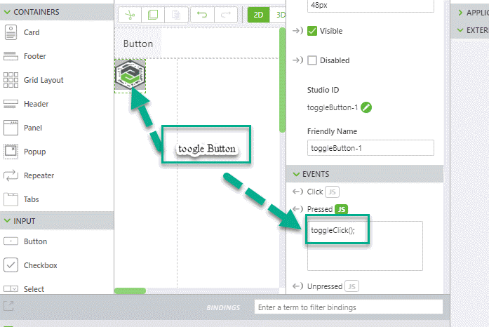

$scope.toggleClick= function()
  console.log("toggleClick");
  $scope.app.playAudio('app/resources/Uploaded/background.mp3');
and call the toggleClick from the pressed event e.g.:
The audio file / here background.mp3  should be first uploaded to your resource folder

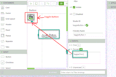

Hi @RolandRaytchev,
     Thank you for your response, I tried to create the experience but I think I am missing some trick here, can you please explain me once more with the snaps which I have provided you. Suppose I am having multiple files similar to background1.mp3 and background2.mp3 which are present in Resource folder and I want it to assign these audio files to the toggle button as that created in the snap provided, what script I need to provide in the Home.js window. So that with first click of Toggle button my  background1.mp3 file plays and with the second click of Toggle button my  background2.mp3 file plays.

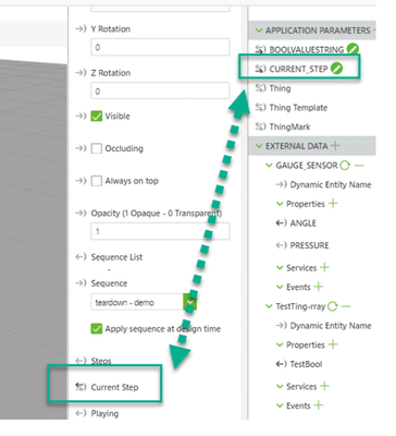

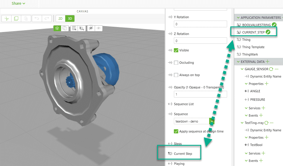

                  Thank you for your response, but still it is not working with the below code provided. I added the CURRENT_STEP feature in the application parameters and linked it with the Current_step in the model properties panel.
 with the implementation of GetCurrentStep as provided by you
    and used the below code for model.js .
  $scope.app.playAudio('app/resources/Uploaded/seq_audio_'+GetCurrentStep()+'.mp3');
   I had renamed my audio files as seq_audio_01.mp3, and so on....and trying to link this to a toggle button which plays my multiple different sequences when I click on it. Can you please let me know with each steps, to follow in detail to get this issue resolved.

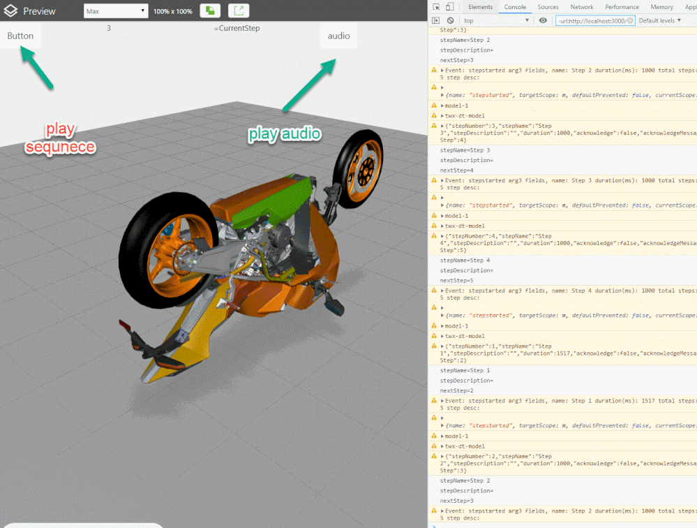

Hi @mady4383 ,
I checked the problem now  but it was working in a test project.
In this project I used both:
1.) played the audio for the current step
2.) used the step started finish to play the audio for the started step
I think the best will be to attach the test project here so you can test by your self.
Please, let me know if you have questions.
