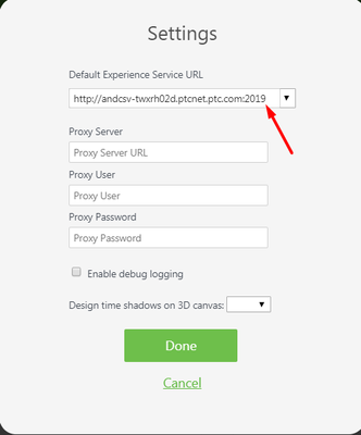

Please update the experience service url in the Settings as shown below:Screenshot_26.png
Now, open an existing project and navigate to Project panel -> Configuration -> Info. Update the experience service URL and hit validate.Screenshot_27.png
It will prompt for a username and password. Please enter the new username and password.

Hi @Warissara ,
