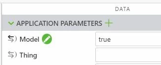

Not sure if this is a bug or ignorance. I am trying to hide a model upon the start of my application and at a certain point make it visible.
I have the visibility box unchecked for the model, but it still shows at the start of the app. Also setting '      $scope.app.view.Maintenance.wdg.Testing.visible = false;' or even True does absolutely nothing. Any help would be greatly appreciated.

To show the model, you can use an application parameter and a small function. First, create a new app parameter. I created one called 'Model' and set it to true.

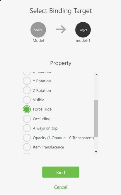

Next, bind your new app param to the Model's 'Force Hide' property.
Then, add the below code to your Home.js file:
$scope.showModel = function() {
  $scope.app.params['Model'] = 'false';
You can then call this function on any event within your experience. I called it on the 'swipeForward' Application Event.
Your model will be hidden until you call the showModel function.

Is this a HoloLens project? You can use the 'force hidden' parameter to hide the model on experience start by doing something like this in the Home.js file:
//test visibility
$scope.Test = function() {
  $scope.setWidgetProp('model-1', 'ForceHide', 'true');
$scope.Test();

Not a HoloLens project. This method worked for me.
I did notice that if a sequence is applied to the model that the visible checkbox does not do anything. With no sequence my original code worked.
If you have a sequence defined, then the sequence settings will usually override the Studio settings.  To make sure that doesn't happen, you can use JS to toggle off the sequence property:
