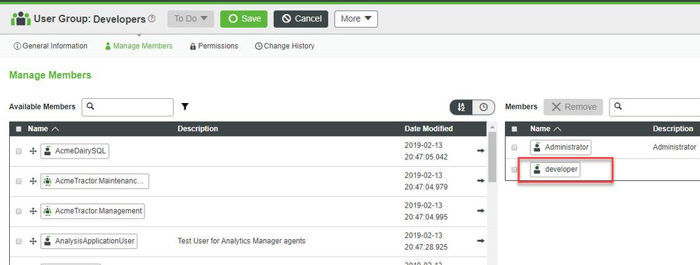

Hi all,
I have a several users that are in the developer group so that they are able to publish to the connected ES.
Along with this, it was my intention that they be able to create, edit, etc entities without giving them admin privileges.
However, they are totally unable to edit, view, or create entities, even within projects to which they belong.
Any thoughts on how to update those permissions?
I want the users to be able to able to create/edit/view entities within their projects without having everyone be an administrator.
This is a cloud portal thingworx instance on 8.4.1

I tested with  the following steps:
-added an user e.g. developer to the members of developer user group
Then I  created  a new experience as developer user (member of TWX developer group) .
