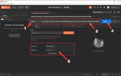

Thank you for sharing this answer. Since the files are no longer in Vuforia Studio, and the cache has been cleared, the only remaining option is following the help center instructions. The help says to use the following command:
curl -u email@abc.com:password -X "DELETE" https://localhost:2019/ExperienceService/content/projects/myabcapp/
I tried entering this in the command prompt on the experience server (with my email and password etc) but the response was
'curl' is not recognized as an internal or external command,
operable program or batch file.
What am I doing incorrectly? I am not familiar with "curl" commands

Hello Wes,
Curl command is available in Linux and in MacOs or in Windows 10 since version 1804.
https://ec.haxx.se/get-curl-windows.html
An alternative in Windows or in Macos, is to use postman.
https://www.getpostman.com/downloads/
I have tried the command in cURL as described in documentation and also Postman.postman_delete_experience.jpg
I have an error reported in both cases.
  "message": "Header x-requested-with is missing or invalid",
  "errorCode": "",
  "error": {}
I am investigating that to update the documentation if needed.

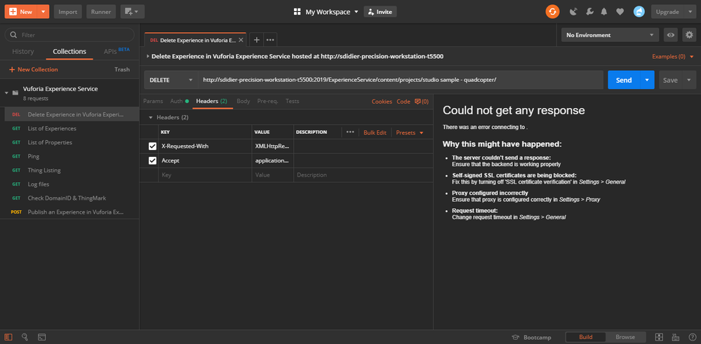

I got it working by adding the following header:
X-Requested-With: XMLHttpRequest
With all the API calls you also need the following header:
Accept:application/JSON

For reference, these settings in Postman :Delete_Experience_Vuforia_postman_header.png
