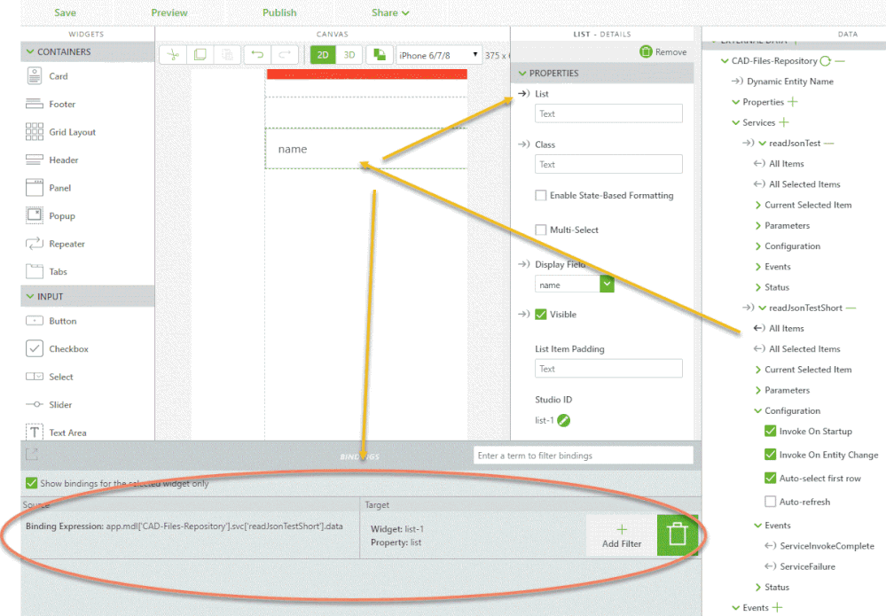

Ok , I checked it and  I think it is  solved for you.
Yes, I did not pay attention, that you used a list widget and not the select widget.
I tested with a service e.g. here readJsonTestShort which returns a InfoTable:
Then added the service as External Data:
And it is correct - then you can find the object of the current selection in the :
$scope.app.view['Home'].wdg['list-1'].list.current
Which contains the whole object for the fields with values for the selected row - dataset of the used InfoTable
In case that you need the number i of the selected row you can use the following construct in the function called by the ItemClick event e.g. $scope.testList()
