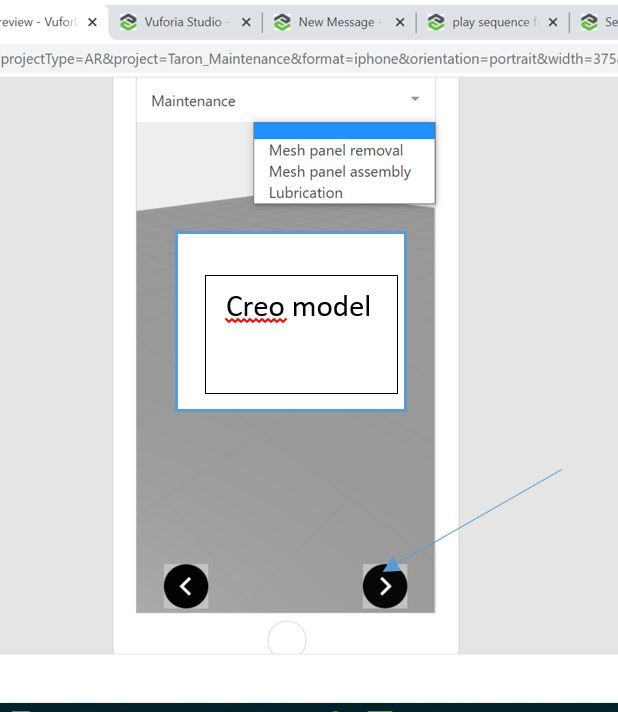

Play and previous buttons are not working
I created a 3 figures in creo illustrator and imported into Vuforia studio. In 2D canvas drag and drop the select widget for creating a list of figures. Below i have attached the code which i used to create a list. List and 3D images are working fine. But I'm unable to play the animation of the sequences.
How to add the buttons to play the animation?. kindly guide me.

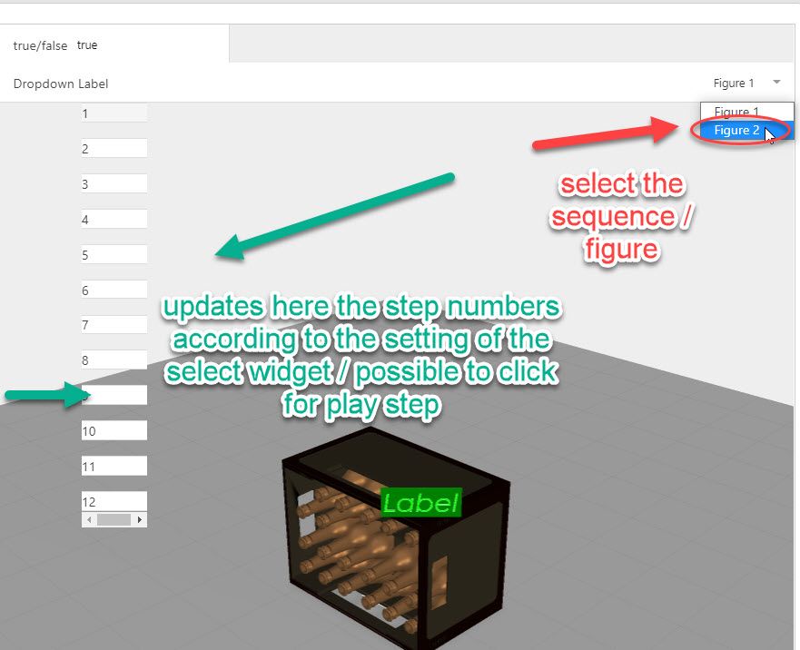

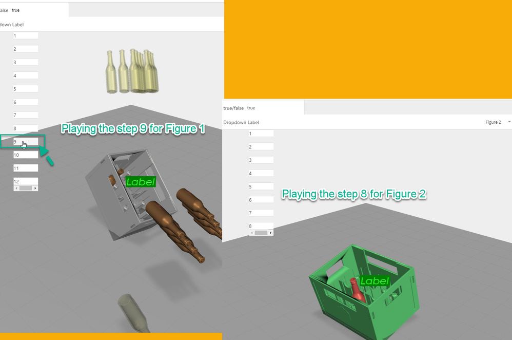

Sep 24, 2020 11:00 AM UTC
here I want to provide a demo project which is similar to this what you obviosly want to achieve but with some differences:
So here we can play for the selected figure (1 or 2) the specific step number by clicking of the step number field - item s of list widget:
Here also attached the demo project.

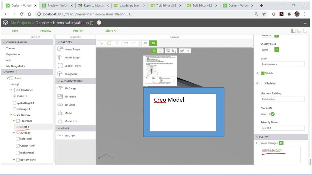

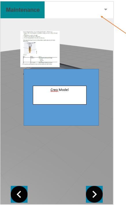

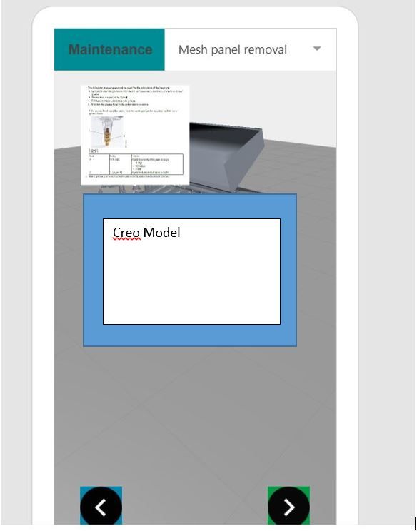

Hi @sebben
Thanks for the exact understanding of my requirement. I tried , the animation is working fine but the 3D-image still appearing to all the sequences. Below screenshot for your reference. I used same script for this model.
$scope.checkSequence = function(){
 $timeout(function () {
 if( $scope.view.wdg['model']['sequence'] == 'l-Creo 3D - Lubrication.pvi')
 $scope.view.wdg["3DImage-1"].visible = true;
 else
 $scope.view.wdg["3DImage-1"].visible = false;
 	},50);
