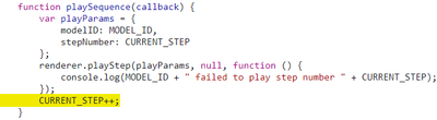

I had now time to work on that project again and i still have no good solution for my Problem.
I have a forward, arewind, and a play button.
Aslong i press forward or rewind everything is fine. The play button is the big issue. As you told, i can make my own play button. i made it yeah, but it's still bugged. And i found why it's behavior is not changeable.
This is a part of vuforia-angular.js
I dont know who had the great idea to make current_step++ at the end of the sequence but in my eyes this shouldnt be the case.
for this it would be enough to have a normal play (without increment) followed by a forward call.
I had the same problem as you, I needed to play the same step over and over again until user decide to move back/forward.
Actually I'm using a custom "playStep" function in place of the embedded one (it's basically the same logic but without the current step increment):
$scope.playStep(modelId, stepNumber) {
    console.log(`---- playStep(${modelId}, ${stepNumber}) ----`);
    let successCb = () => { console.log('success')};
    let errorCb = () => { console.log('error')};
    tml3dRenderer.playStep( {"modelID":	modelId, "stepNumber":	stepNumber}, successCb, errorCb);

Yeah, that helps alot. I don't know why i didn't see it. But with your help i can now fully implement what i need.
thanks alot!
and thanks aswell to RolandRaytchev.
