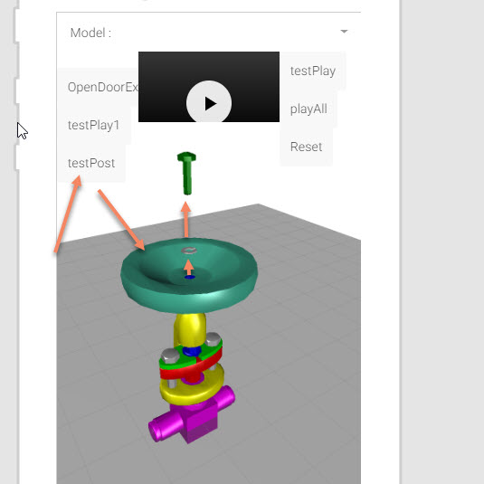

I'd like to know if there is a Javascript way to play specific step of PVI sequence at studio?
The following line works to play all steps of animation.
$scope.app.params.sequenceURL = "app/resources/Uploades/<name of PVI file>";
angular.element(document.getElementById('model-1')).scope().play();
Instead, I'd like to play only step 2 using JS. Inside this PVI sequence, there is 3 steps.
Thanks in advanced!

Hi Kelson,
There is a specific property for the current step in an animation. you should be able to call it as $scope.view.wdg['model-1']['currentStep']
Then, you can set that equal to 2 if you want to play step 2. After that, you should be able to start playing the animation as you would normally, and it should start on that step, but I'm not 100% certain as I haven't tried it myself.

I think your code is working fine but there are 2 things to change.
1.)(consider this point only if you do not did it already) upload the pvi file form the pvz to the upload folder - (copy name.pvz to any_name.zip and upload the file l-Creo 3D - Figure2.pvi to the upload folder )
2.) use instead of 'Uploaded/l-Creo 3D - Figure2.pvi' this one 'app/resources/Uploaded/l-Creo 3D - Figure2.pvi'
So I tested your script in a project :
$scope.sequence2 = function () {
$scope.view.wdg['model-1']['sequence'] = 'app/resources/Uploaded/l-Creo 3D - TestFigure1.pvi';
$timeout(function () {
$scope.view.wdg['model-1']['currentStep']=2;
$scope.$root.$broadcast('app.view["Home"].wdg["model-1"].svc.play');
}, 500);
An it was working fine, The step 2 of the sequnece was started.
So step 2 of sequnece "TestFugure1.pvi" was started
Still doesn't play the right step animation. It should play every time the same step when I click play, right? It does not do that.
So tested it and you right! It does not play for example when I use some other step ... let say step 4.
So tested it some time and modified and now is working with the followig script:

Thank you very much, it worked just perfect. It was the incompatibility with syncronous.
