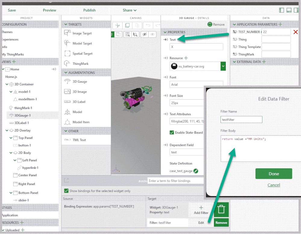

The problem with the the method described in the post  -> is if you add a filter to the text property so that you can add units to the value, e.g. '10%' then the state based definition wont understand the value as it is now a string and not a number.
Is there any way to work around this?
It would be great if the dependent field could instead be a dependent value and then you could bind the property itself to the 'dependent value' so that you can have units and a colour changing gauge.

Hi @randerson-3 ,
after I received a hint form PTC develpment team I have now the corect  solution for this issue:
So the test will display the correct results.
The following steps.
1.) define an application parameter e.g. TEST_NUMBER
2.) bind it to the 3d gauge text value and use a filter to define the unit sufix
e.g.  Filter Body :
return value +"MM Units";
3.) Add the following script to the <Current_View>.js  / e.g. Home.js here
$scope.$watch( // watch for the color setting
 function() {
 return $scope.app.params['TEST_NUMBER'];
 function()
 $scope.setWidgetProp('3DGauge-1', 'hiddenValue', $scope.app.params['TEST_NUMBER'])
 $scope.setWidgetProp('3DGauge-1', 'stateFormatValue','hiddenValue')
 //end of the second function
This will lead to the correct display / as shown in the picture above.

Hi @randerson-3,
there are 2 points :
1.) using a filter for the binding. Yes, this is correct the filter will change your value. Therefore, the state formatting will not work
When we add a filter we will add a filter to the binding and this we will change the value , which will be pass  to the state and therefore it  will be not handled /will not work
2.) the other point in your question is about the dependent field.  I do not think that using it will make here any sense, it if you assignee a incorrect value to it - in this case the state formating will be disabled.
According PTC development team there is often  some misconception around the use of "Dependent Field".
Dependent Field must refer to the name of a property directly on the widget (ex. Font, Shader, etc.) and not the value of anything elsewhere. So when binding anything to Dependent Field, make sure that this value is the name of a property on the widget itself, and not a value to be compared to with the State Format

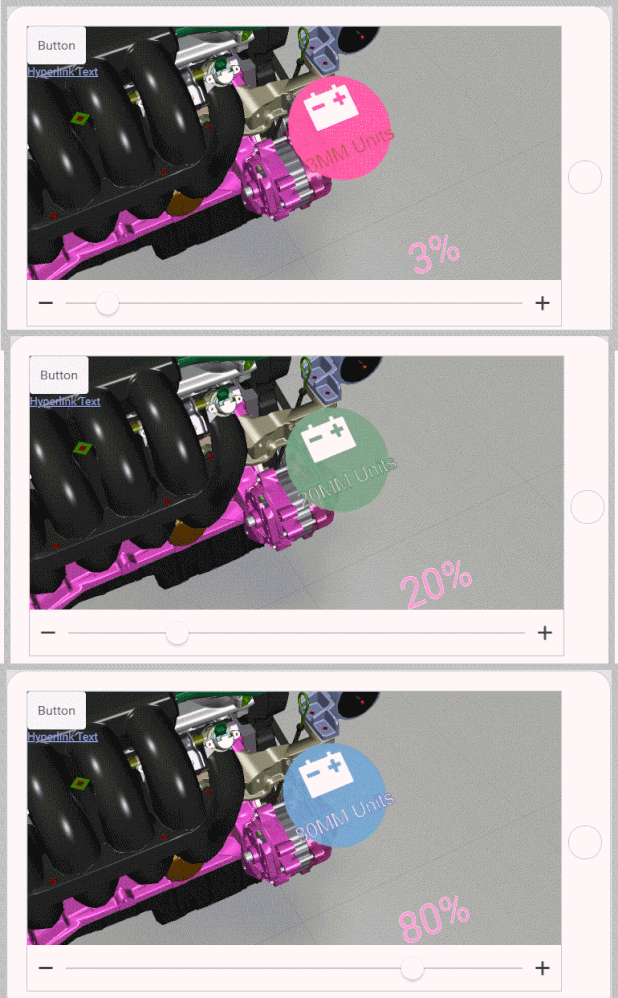

Possible Workaround /Solution
So, I think one possible thing what we can try -> we can use a font / format style for the gauge  text to make the font invisible and replace it with a 3d label text  where we should display the value with the units. We can bind the label to the same application parameter e.g Some think like:
Where we will try to set such Text Attributes for the Gauge so that the text will be not visible.
e.g.
Text Attributes = fill:rgba(0, 0, 0, 0);textbaseline:middle;textalign:center
This was the first attempt which was not perfect but should explain what is intended.
so here the result for the test
Another attempt could be to try to use some style format, where the unit suffix will be added by some  style elements. I could not find such style definition but wanted to mention here just for the case.

Hi @randerson-3 ,
So means to use the depending Field value / in script the stateFormatValue /as you initially tried   with a “little change” led finally  to the correct solution Smiley Happy
