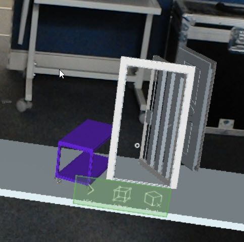

So I've been trying to create an animation of a door opening and there's a problem with the playback on the HoloLens.  When I preview the experience, it looks fine but when playing it on the HoloLens, the door does not pivot about the hinge, but does this weird movement where it moves off the hinge, pivots and moves back onto the hinge as is reaches the end of the movement.  Attached is a recording of what I mean.
I've tried creating the animation in Creo Illustrate 3.0, 3.1 and 4.0 with the same result.
Any updates on getting a fix for animation playback on the HoloLens?
Allan

I tested some sequences on the HoloLens and think some sequences steps which are  working on other devices (Android) still causes a problem on the hololens.:
- sequences generated with new versions of Creo Illustrate e.g. 4.1 or 4.2 but I suspect in same cases that the best results are achieved with the version 3.0 or 31.
- the pulse, and the shake effects, the unscrew and the fade out affects could causes very often problems when they are used in a step with more other effects. Mostly these effects will not work or will cause a wrong transformation of components. Therefore, such steps should be tested also on the end device
- some times problem occurs when the size of the thingmark does not have the correct size in mm  and does not match the  size of the  scanned thingmark. Actually often this is used to  have an additional scale of the  model but this could cause problems for the correct display of the sequence steps
- On the HoloLens seems that is better to extract the .pvi file and to upload it to the project Upload directory explicitly ,especially when we want to change the figure via scripting
- in some cases, expectably on the HoloLense we can help with JavaScripts. For example for the door rotation we can use some script where we can move the rotation axis of hinge  via relation (it is the Creo Defautl Csys  is no coincident with the desired rotation axis) and use the setInerval function:

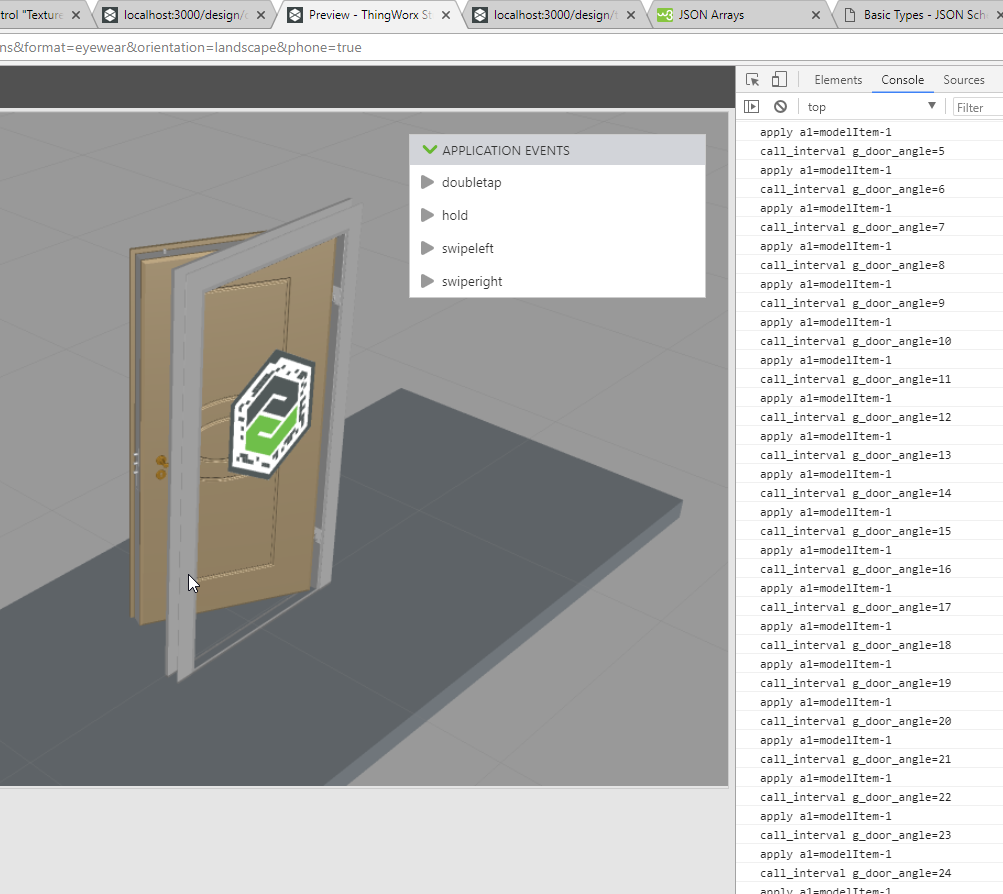

$scope.view.wdg[modelItem]['rx'] = angle1 ;
$scope.view.wdg[modelItem]['y'] = 0.0 - l_door*Math.sin(angle1_rad);
$scope.view.wdg[modelItem]['z'] = 0.0 - l_door*(1.0-Math.cos(angle1_rad));
So the sample  code (tested on the holoLense device is the following)
// $scope, $element, $attrs, $injector, $sce, $timeout, $http, $ionicPopup, and $ionicPopover services are available

 The coplete HoloLense Project is uploaded on this link
Hi Roland,
Many thanks for sending this through.  I opened up the project and can see the door opening and closing, so while it's a workaround, it's a pretty daunting one for a non-javascript person like me.
I recently created an experience showing a machine that had 3 different access doors.  So In Creo Illustrate I created 3 models with a door open and close sequence.  Then I could just bring those models into Studio in the correct position and users can just click each of the the doors once to open and click again to close.
This works fine when creating an experience for mobile devices and really goes to the strength of Studio in that I can author without needing to code.  I should also be able to do this for the HoloLens, but there's still this problem of how it interprets the PVI information like you pointed out.  It would be great is this could be fixed rather than having to rely on a lot of code to redo what I've already done in Illustrate.
Many thanks,
Allan
