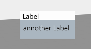

Hi @dsgnrClarK ,
that gif looks pretty neat. I think I described the problem wrong.
It is difficult to have several text lines in front of card board.
When aligning it looks like this:
But after activating billboarding & always on top and changin the perspective, it looks like this:
But I think the 3D-Container should solve the problem.

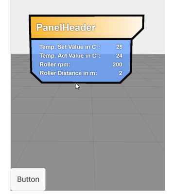

For everyone having problems with displaying many lines of information in one panel i can recommend the use of the 2D Canvas as it helped me alot in my experiences.
Some Code Snippet to try out yourself:
Just put some new 3D image on the Canvas and a Button and use the Buttons Click Event with this:
createInfoPanel('3DImage-1',"PanelHeader",4,{"Temp. Set Value in C°":"25","Temp. Act Value in C°":"24","Roller rpm":"200","Roller Distance in m":"2"});

$scope.createInfoPanel = function(widget/*STRING WidgetName*/, headertext/*STRING PanelName*/, itemnumber/*Integer Rows to show*/, daten/*JSON*/) {
//Parameter
var bodyHeight = 80 * itemnumber;
var keys = Object.keys(daten);
//Longest String
let allwordlength = [];
for(let i = 0;i<itemnumber;i++){

tml3dRenderer.setTexture(widget,canvas.toDataURL());
Final Look:

the trick here is not to use multple objects, as the composition will never work as you thin (and this is true in the 3d example posted here - you can see the labels from one sphere overlapping another) so the trick is to combine the label and the backplate image into a single entity.
the tml sensor (which is what the gauges are built from) supports this - you can mix image and text content onto a single entity.  The gauge widget provides the necessary fields - resource (the image) and text - so you don't need to understand tml to get the basics working.  Take one of the 3d gauges and experiment with changes to the settings...
