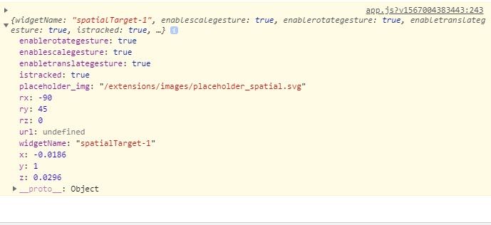

The problem is that so far I know the model scale is not the same as  the scale of the gesture scale (Spatial Target  widget property  ' Enable Scale Gesture ' is selected ) The scale using gesture is a property of the spatial target and some factor which will scale all models in the project (this is similar if you scale a thingmark size). The model widget scale property scales only a particular model. For example, if you have more than one model we can see that gesture scale will scale all models but the model scale will scale only a particular model. So the “Reset Gesture changes” will reset all changed of the gesture scale but it will not change the model widget scale property. what I believe here  is that you want  to change directly the scale of spatial target.
I tried to check the properties of this widget (not only the visible)
We can see there are some additional properties what we can change via JavaScript code
Example:
$scope.view.wdg['spatialTarget-1']['y']= $scope.view.wdg['spatialTarget-1']['y']+0.2
But I do not think that this could be helpful in your case

Thanks for the reply! Yeah, you kind of summerized what I wanna do really good. I also noticed that the model scaling value is not connected to the spatial target scaling value while playing around with this. Personally I think that if you could influence the spatial target scaling value in some way without affecting the rotating and positioning of the spatial target is easiest but what I what to is just some smooth way of indicating scale. Different approaches I have been thinking of and tried is:
Ideal way: Getting an output value of the scaling value for spatial target
Other ways: Reset button that only affect the scaling for spatial target but not positioning or rotation (that way you get an indication of the scale if you know which scale you start with e.g. 1:1. Also, I can have the reset button and make positioning and rotation unable, but that is really bad trade-off I feel).
Another good way: unable scaling for spatial target and use the scaling function for the model but you don't use buttons or spin widget but you can use the pinch gesture to affect the scale value of the model.
According to PTC R&D team now scaling is turned OFF by default . This is considered as functionality which could help to have a better overview but is not intended for scaling of objects:
"For example, you may have a 1:18 model car with a label above it - if you scale the car up to full size (18x larger), you do not scale the label by 18 as the position will be wrong and the text will be huge. Likewise if you scale down, you do not necessarily want annotations like text etc. the scale.  Thus scaling is generally not advised - build your experience to the scale that it will be used. "
So means that if you want to scale and transform  the models will be better to use the Model Widget properties scale and x,y,z ,rx,ry,rz
Therefore, I do not believe that we can expect change on this functionality soon.
