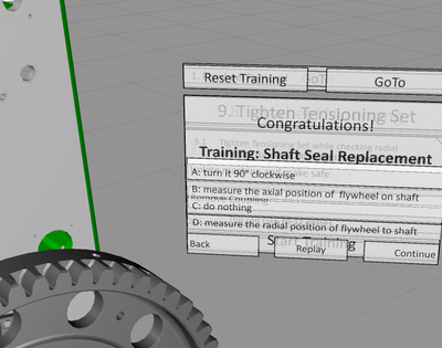

My scenario is build up in a way that there are a lot of 3D-Images-Widgets and in Javascript I control when which Image is visible in order to go step by step through a training. In some of these widgets I implemented Click-Events with functions so they act like buttons.
It was running very nice but since I updated to Version 8.5.7.4613 I can't click the buttons always because the ones which are invisible are still clickable which results in a mess. It's because some buttons are on the exact same place and when I click on the button you have some chance to click the correct visible button but mostly it clicks on one which is invisible and should not be clicked.
Can I somehow deactivate these Widgets totally?
Or is it maybe a bug because it was running before the update?

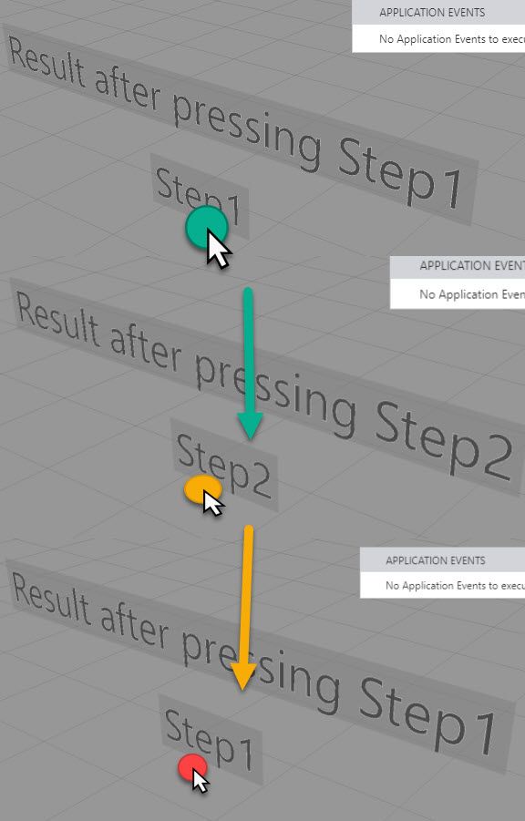

Regarding the 'disable' property I can't disable the 3D-Images.. Is this even possible because in the Widget-Properties I don't see this property? I also tested the command $scope.setWidgetProp('test','disable','true'); but it didn't help.
I prepared a simple example and made a ZIP file out of the project from "..\Documents\VuforiaStudio\Projects" and attached it. Can you work with that?
In the simple example I have 2 buttons on the same place. If you click on the visible start button, the invisible second button gets executed..

yes, could reproduce the problem , -boo definitely -not good!  ☹️
No idea how such problem could occur- means issue occurs also when we register listener in JS .Needed some time to find workaround. Currently the only workaround, I found after some checks,  is to move the element in z direction - example:

this problem is only related to the preview mode of Studio itself, in runtime on the device you will be still able to click the right widgets. We try to figure out where the problem is and try to fix it. Thank you for your message!
