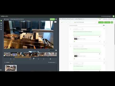

The HoloLens 2 also could be used as scanner of the enviroment but this is only supported (so far I know) for scanning of the spatial anchor based location - according to Article https://www.ptc.com/en/support/article/cs370544
and https://www.youtube.com/watch?v=ZBAmc_Ibo7A (Editor - Vuforia Capture) I think internally it creates as part the capture file also an Environment scans , but I as mentioned already it is not supported and I did not tested it if it could be used as Area Targets
