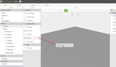

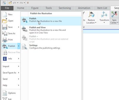

I'm not sure if I really understood what you need but to have the sequence that you've created through the Illustrate imported in the Vuforia Studio you just have to:
1- publish the sequence as a .pvz

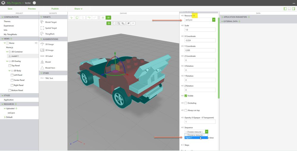

2- at the vuforia studio you just need to drag a a 3d model to scene:
3- Select the .pvz you've saved as the model resource, and select the sequence at the  sequence attribute.

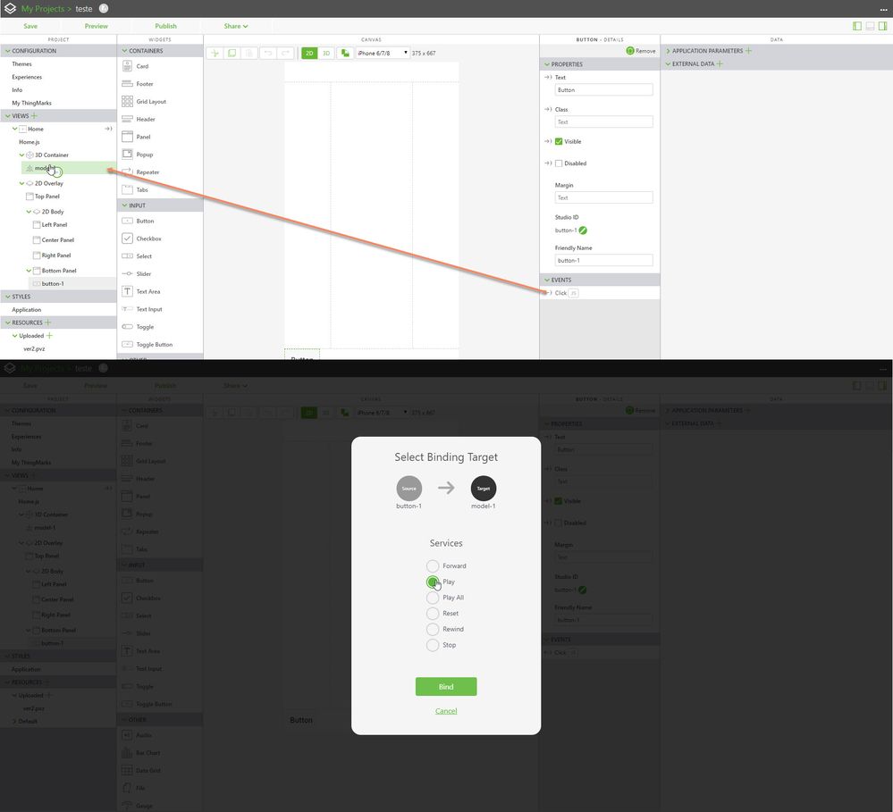

At last, you just have to create a kind of button in the 2d layer and bind the click to the model PLAY service:
Done.
