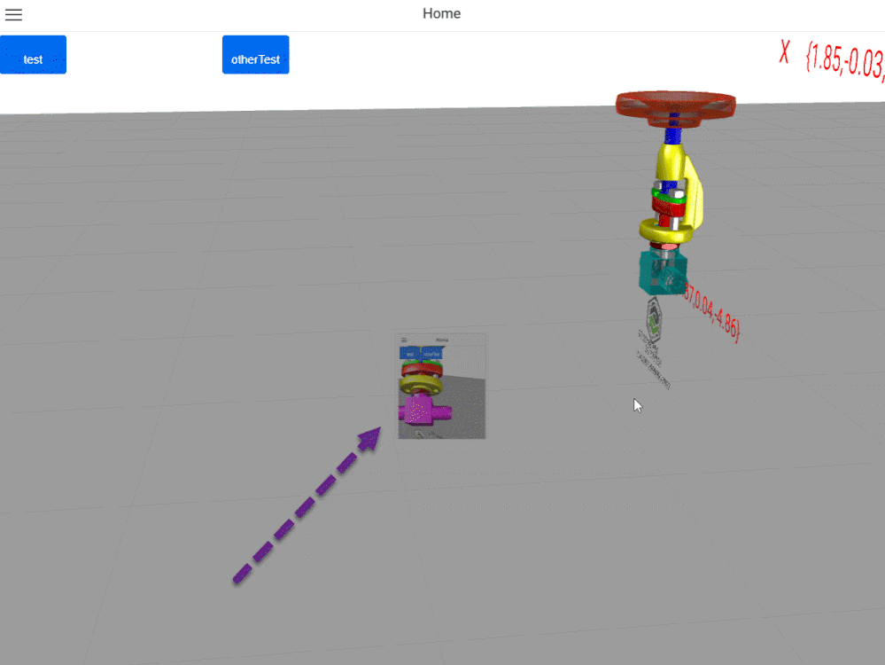

I am currently working on a HoloLens experience which will be used in large physical space and the users need access to some of the information no matter whether they are near the loaded experience or not.
The HoloLens Start menu and the Vuforia Studio Experience selector menu uses the concept, which Microsoft calls tag-along.
Is it possible to include/edit this property for a studio 3D Label?

So that I think , you want to have some kind of dynamically movement of elements to stay in same position in relation to the gaze vector and eye postion.
The answer is ... it could be possible ![]()
Let explain.
-currently in the HoloLens our AR world is the Vuforia View application. This means you need to use one of the possible tracking methods to have a position for all object in the space. So when you scan for example a thingmrk - in this case this is our world coordinate system and all 3d object are located in regards to model coordinate system. (actually the model coordinate system is an offset to the thin mark because it is seldom to the point 0.0,0) IF you move the location of the thingmark and scan it again , then the position all 3d objects will update regarding the new location of the thingmark.
But we have a functionality what may be helpful here. We can track the eye /camera position by having position vector, eye_direction vector and eye_up direction. In this case theoretical you can calculate every time when you eye /HoloLens device is moved or rotated - so that you will have the effect like some kind of billboard to your HoloLens.
The following code :

Regarding to the calculation of the correct values of the 3d element coordinates - it could be a little bit complicated but is still possible . Also, we need to have such calculation for each object we want to move.
The most trivial way is simple to set the billboard property of the element and to move only the position
var scale=5.0;
$scope.setWidgetProp('3DImage-1', 'x', ( eyepos[0]+eyedir[0]*scale));
$scope.setWidgetProp('3DImage-1', 'y', ( eyepos[1]+eyedir[1]*scale));
$scope.setWidgetProp('3DImage-1', 'z', ( eyepos[2]+eyedir[2]*scale));
So it does not matter where we move the model ( move because I tested it here in preview) the 3dimage goes always to the screen center and with a distance offset to the screen plane in eye direction
Of course we could do a more precise positioning but need some additional mathematical consideration
