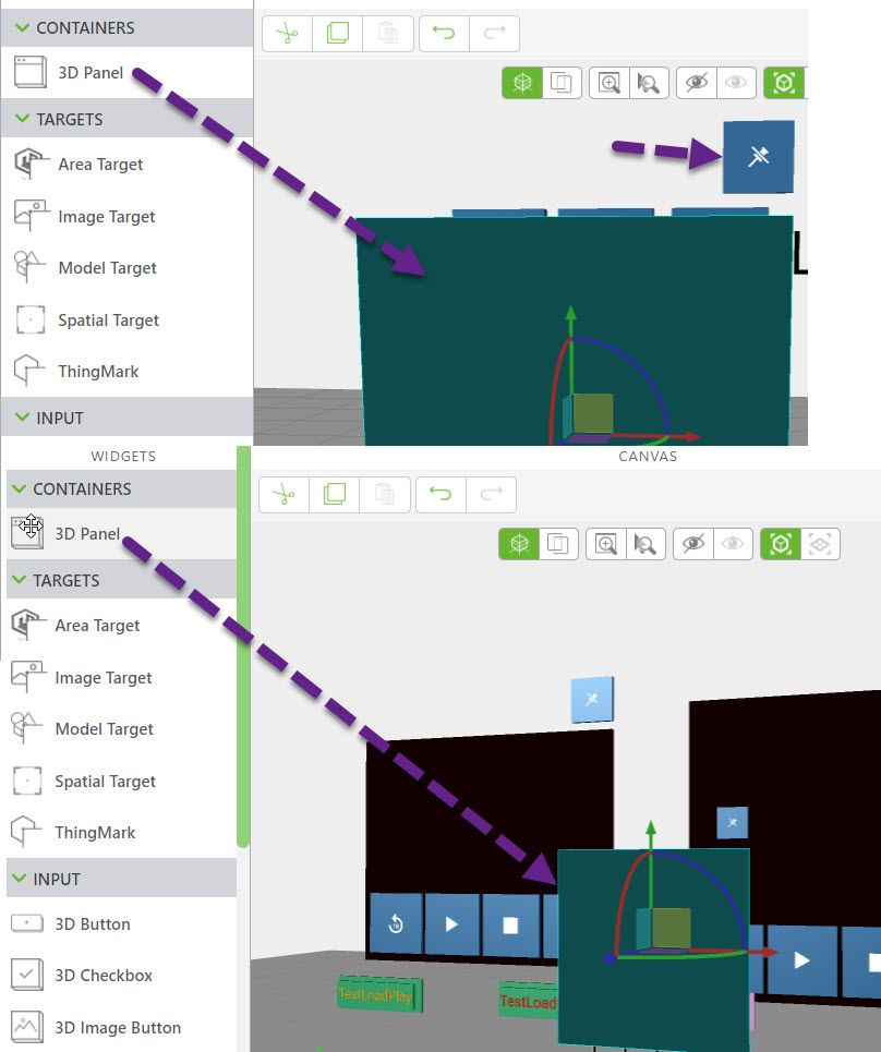

Hi @RolandRaytchev How to add the 3D adaptive panels to Vuforia studiio experience, I cannot find this anywhere.
Hi @amarshall-3 ,
3D Panels and other 3D widgets like 3D Video are available for mobile and eyewear devices (mobile) , but there is difference between how it work on HoloLens and mobile. In a new project with the latest Studio version, you can add them from the widget panel
Here is a link to the Studio Help e.g.  3D Panel   and 3D Video   , This is convenient way to create 3D adaptive UI.
There was an old techniques (before the 3D widgets are introduced In Vuforia Studio) which requires significantly more work to be implemented – here I  want  to refer to e.g. following community posts How can we make a 3D Widget on HoloLens visible in front of me everytime ?   and Design UI in 3D Eyewear (Hololens II)
