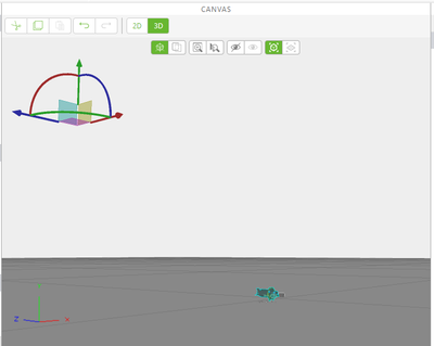

Hi All,
I imported a model file in FBX format into Vuforia Studio. And I found that the coordinate of the model was not in the center of the model, but shifted to a strange position. Why did this phenomenon happen? How can I solve this problem?

The problem has been solved. The reason for the coordinate deviation is that another Model item has not been recognized, and the distance between this Model item and the main body is too far, resulting in that the coordinate of the overall model is not in the center of the model.
