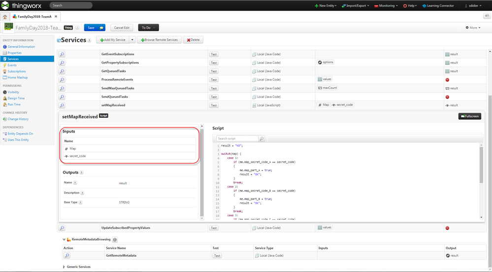

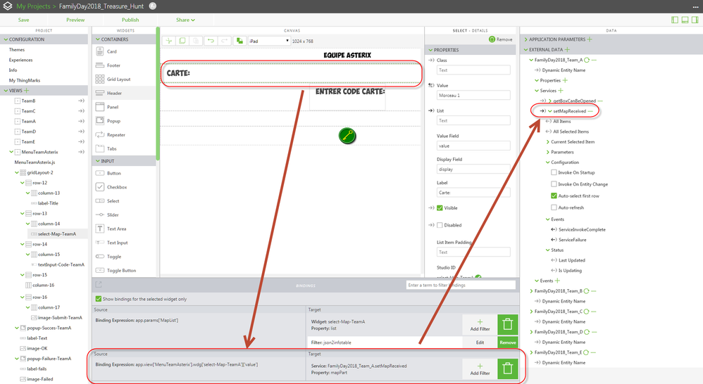

Yes it is possible to change a value from an Experience to a Thing in ThingWorx Platform.
For a better troubleshoting, in ThingWorx Platform, I have created a Service into the Thing.
We can add log message. It is needed to debug with log files.
In my example, this Service, receives 2 values from Vuforia Studio, from 2 Widgets.
In ThingWorx, to troubleshoot, I use the Monitoring > LOGS > Application, Security and Script menus.
It is very useful to know if the problem is in the javascript code or in Permissions.
By the way, it is possible to test the Service by clicking the Test button.
It is useful too, to exclude a problem with it in javascript source code.
Also, I would recommand to test with a dev account in ThingWorx but also with the es-public-access direclty in ThingWorx Composer.
About Permissions, in PERMISSIONS > Run Time, for es-public-access user, all Permissions need to be enabled (green dot icon)
