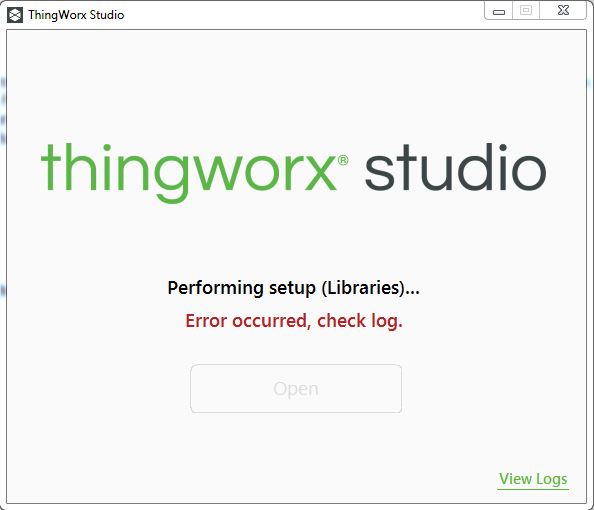

Thingworx Studio install error
I am getting an error message when trying to install Thingworx Studio, see attached screenshot and log. Can anyone advise how to fix this?Capture.jpg
[05/28/2018 09:56:32] Studio Version 8.2.3 (8.2.3.3224)
[05/28/2018 09:56:32] Status Message: Version 8.2.3 (8.2.3.3224)
[05/28/2018 09:56:32] Status Message: Performing setup (Application)...
[05/28/2018 09:56:32] Unzipping mbdist.zip to C:\Users\gavin.donald\AppData\Roaming\ThingworxStudio\studio-download.vuforia.io\

[05/28/2018 10:00:22] Starting node.exe
[05/28/2018 10:00:22] error: [twx-studio:index] uncaughtException Error: HOME directory does not exist. Environment variable HOME=C:\Program Files\LFM Software\LFM\home Fix the env variable and relaunch studio.
[05/28/2018 10:00:22] ThingWorxStudio dir: C:\Program Files\LFM Software\LFM\home\Documents\ThingWorxStudio, home dir: C:\Program Files\LFM Software\LFM\home\Documents
[05/28/2018 10:00:22]     at _verifyHomeDir (C:\Users\gavin.donald\AppData\Roaming\ThingworxStudio\studio-download.vuforia.io\dist\server\commonProperties.js:37:11)
[05/28/2018 10:00:22]     at Object.<anonymous> (C:\Users\gavin.donald\AppData\Roaming\ThingworxStudio\studio-download.vuforia.io\dist\server\commonProperties.js:40:1)

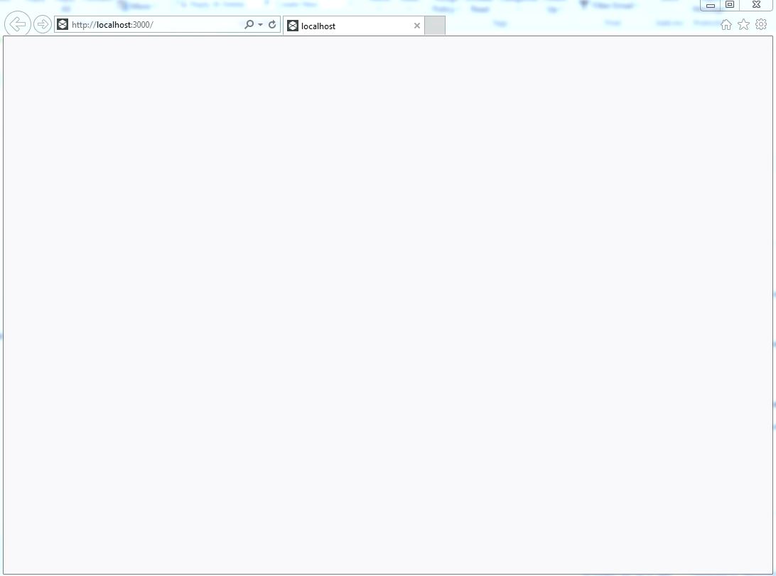

dupatel
(To:rds)
@rds Do you see same behavior when you open URL http://localhost:3000/home in Chrome browser ?

dupatel
(To:rds)
@rds From the error it seems to be issue with environment variable or user profile who launched the installer.
Could you please retry Installation by right click on installer and doing "Run as Administrator". Also, Delete the files under <user home>\AppData\Local\Apps\2.0\ and re-install the studio exe file.
The AppData directory is an hidden directory, make sure to enable 'view hidden files' windows configuration.

Capture 2.JPGHi Durgesh,
Thanks for your reply. I tried doing what you suggested and I also recruited the help of my IT department but still no luck. For some reason the installer is looking for a "home" folder in the LFM software directory. We manually created this folder (not understanding why) and the installer progressed past the previous sticking point. I clicked the Open button and it opened an IE window with address http://localhost:3000/ but all it's just a blank page and nothing happens. See screenshots I've attached and log.
-Durgesh
rds
3-Newcomer
3-Newcomer
(To:dupatel)
Yes it works in Chrome, thanks for suggesting that. Now the only problem I'm having is trying to configure and connect to the Developer Portal account so I can access projects and get the ThingMark. I've entered the correct email address and password but I get an Auto configure failed message, see attached.
dupatel
(To:rds)
@rds Good to know it worked on Chrome since at this point of time only Chrome browser is supportable with Studio.
Do you see any errors in Studio application logs when you try auto configure ? Please attach logs post auto configuration attempt and share your User ID been used.
