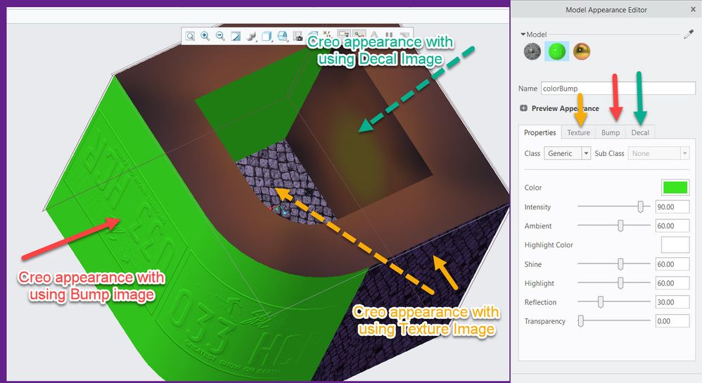

@sebben  As mentioned earlier that the "Default" shader works, but apparently it also removes the texture which was given to the model item in Creo Parametric. After applying the "Default" shader, I have noticed that the model item's appearance changes to the base coat color applied in Creo Parametric.
Hi @Ace_Rothstein ,
the current behavior is that when we use colors and textures in Creo Parametric appearance in this case the colors and the Texture and Decal are displayed in Studio (the Bump is not displayed  in the current functionality yet)
So if we have the behavior in Creo Parametric:
In studdio we will see the creo colors, the texture and the decal setting of the creo apperance
Let say that the model (only part ) is model-2
When we call the javascript code:
$scope.view.wdg['model-2'].shader  ="Default";
then we will have only the creo parametric colors

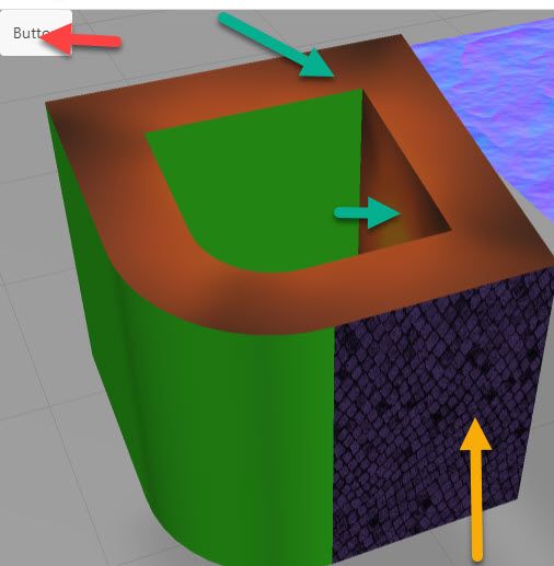

but we can switch again to the apperance with texture display calling :
  $scope.view.wdg['model-2'].shader  ="undefined";
  $scope.$applyAsync();
the it looks like:
