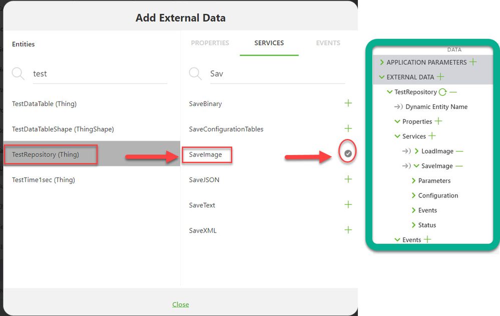

1.)  add the twx service for the specific repository thing to the external data section:
2.)  add the following javascript to  send the data to Thingworx repository  path: / pictures

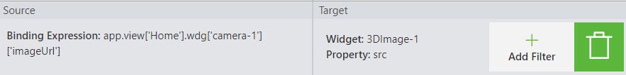

This could be done directly by binding e.g.:
or  by js  - something like:
 $scope.setWidgetProp('3DImage-1', 'src', $scope.view.wdg['camera-1']['imageUrl']) ;

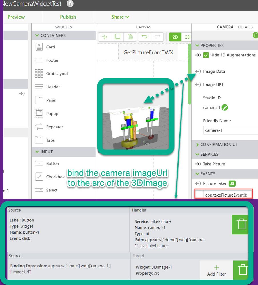

3.) add to function  app.takePictureEvent()  to the UI of the camera Picture Taken event:
4.) create a binding for the camera widget property imageUrl to 3DImage resource (src) property . This will have the effect that when you have taken a photo then it will be displayed on the 3DImage. Also via the UI js Box it will call the app.updatePicture() function - where the  data will be send to the Thingworx repository

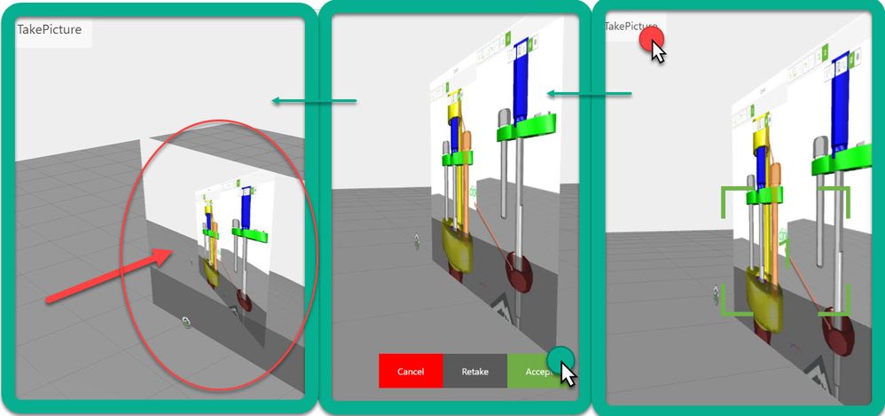

5.) when we test it in the preview mode  - we will have some thing like this:

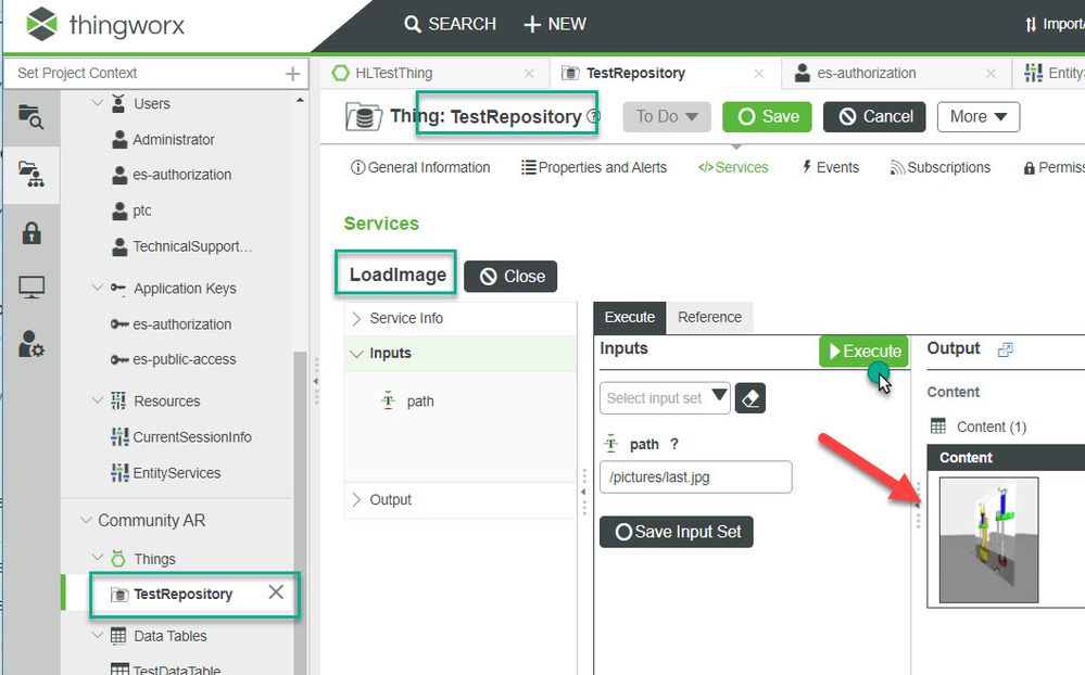

6.) go to TWX to check if the data was sent: Here we can call  the repository service LoadImage( path = /pictures/last.jpg )  - When we test it - we can see the picture which was sent to TWX:

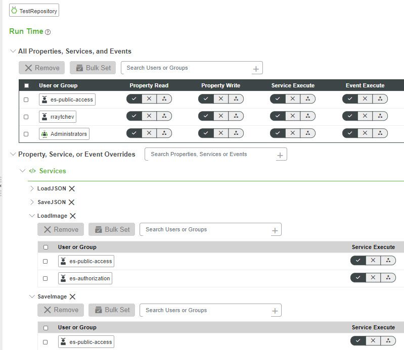

 7.) If the experience should be used without credentials in this case we need also to set the permission of the service SaveImage for the es-public-access group:
