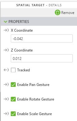

Hi there. I am currently developing an experience in Vuforia Studio and the AR experience will be shown on Vuforia View.
Can I perform the translation or rotation by only using touch gestures but not using the slider? It is similar to the examples in the Vuforia View, Helicopter Assembly, as it allows the users to move or rotate or zoom the helicopter by fingers.
Solved! Go to Solution.
These features are available within Spatial Target experiences only at this time. One thing to note is that the gestures must be enabled within Studio on the Spatial Target widget.
So, I cannot enable gestures when the ThingMark is being used?
correct. Gestures are not available for ThingMark experiences.
