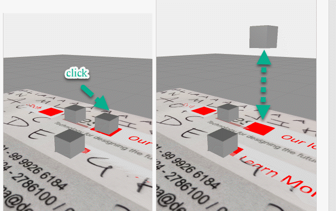

I want to translate a model in Y direction using javascript but is not able to do so. I tried a method given by Roland Raytchev in this link https://community.ptc.com/t5/Vuforia-Studio/3D-object-movements-using-JavaScript/m-p/592546#M5001
but was not able to do so. I also tried quadcopter example but due to lack of coding experience was again unable to do so.
Any help would be appreciated.

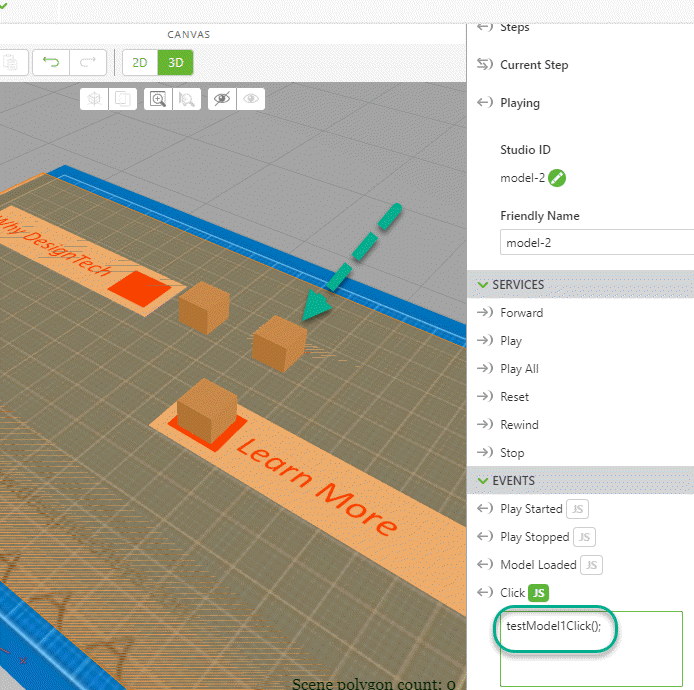

  1. In 3D View, add a Model named model-test
  2. In 2D View, add a Button
  3. This button should a Javascript function (For example the Javascript function is named moveOnYAxis() )
  4. In the BUTTON - DETAILS panel, in EVENTS section, in Click event, click on the button named JS
  5. In Expression text editor, enter moveOnYAxis()
  6. This Javascript function is defined in Home.js file (if the View is named Home as the default one), enter this code :

I have just one more question. I tried to move the model in -Y axis edited the code but it didn't work. Can you tell me where did i go wrong?
Hi @vivekse ,
yes there are some errors in the JavaScript implementation of this function.
I modified the code so that it is working now.
-added negative direction. To make it simple- when speed or direction is negative, or both – in this case it will move the model in negative direction. Also, I did pass the arguments to the setTimeout function. It seems that it took in the last version of the code the arguments value at time when the asynchronous call was executed but not the argument value at the time when the function was called / - there is delay - which was not considered so that the distance was not correct. Now I think it works
Following example code with functions testModel1Click(),testModel2Click(),testModel3Click)/ for the click events respectively of "model-1", "model-2" and "model-3":

In this project I want model-1 to move +y direction for a certain distance when clicked on it and after 10 seconds model-2 and model-3 should also move in +y direction for a certain distance(lets say their y coordinate increases by 10 units). And thanks for the previous reply.🙂
