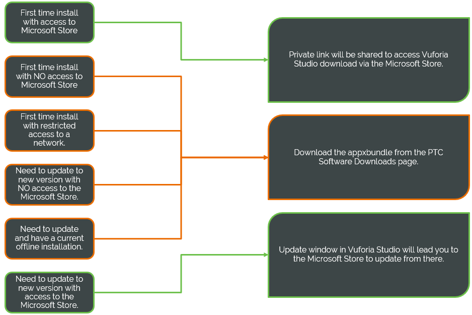

UPDATE: As of Studio 9.10, the appxbundle for offline installs and the Microsoft Store version of Vuforia Studio are now available. See the following Help Center topics for more information:
We encourage users to use the new installers that are now available, as the legacy installers will no longer be available on the PTC Software Download page with the next release of Vuforia Studio.
We are planning to introduce a new and improved way to install and upgrade Vuforia Studio for Windows in early 2023. This change will allow Vuforia Studio to be deployed, installed, and updated via the Microsoft Store. An appxbundle will also be available on the PTC Software Downloads page to be used for SCCM deployments, command line, or offline installations. To understand how this change might impact you, see the below scenarios:
Please reply to this post with any questions or concerns on this upcoming change. Additional information will be provided as we get closer to launching the new installer.
