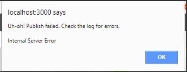

I am unable to publish any project from Thingworx studio trial license(unexpired).
When I try to publish I get the following error message and attached is the log. Will appreciate at help!!

Hello abhide-4,
The last error reported in the log is about the server https://mytest.pp.thingworx.io.
To be honest, I didn't find a Vuforia Experience Service hosted in PTC Cloud with a such URL.
I have also tried to access to this URL in my web browser, without any success.
It explained the error reported when publishing an Experience.
This server is needed to publish an Experience.
So, here, I suppose that in Vuforia Studio, in the Project, in PROJECT panel, in Info menu, in Experience Service field, we can see this URL.
  • Can you confirm us that, please ?
