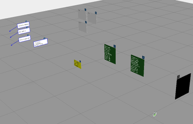

Hi All,
Hope if you can share with me if you have encounter the following, and how did you go about resolving:
I am using : ExperienceService version is 9.9.0-f620013
When i publish a hololens (3D wear) project,  i encounter the following:
1. I am able to publish.
2. when i connect the hololens with the ExperienceService, i am not able to load the project in the vuforia view.
3. The following error can be see in the log:
(node:14848) UnhandledPromiseRejectionWarning: TypeError: Cannot read property 'selectWithParams' of undefined
at Object.exports.getExistingRecordForAnExperience (C:\ptc\studio-es\services\advancedmtg\trainingDatabaseService.js:83:22)
at Object.cancelObsoleteHMTGJob (C:\ptc\studio-es\services\advancedmtg\hmtgHelperModule.js:508:51)
at getFileInfos (C:\ptc\studio-es\routes\handlers\target-generation\eventHandler.js:87:16)
at C:\ptc\studio-es\routes\handlers\target-generation\eventHandler.js:64:24
at _fulfilled (C:\ptc\studio-es\node_modules\q\q.js:854:54)
at C:\ptc\studio-es\node_modules\q\q.js:883:30
at Promise.promise.promiseDispatch (C:\ptc\studio-es\node_modules\q\q.js:816:13)
at C:\ptc\studio-es\node_modules\q\q.js:624:44
at runSingle (C:\ptc\studio-es\node_modules\q\q.js:137:13)
at flush (C:\ptc\studio-es\node_modules\q\q.js:125:13)
at processTicksAndRejections (internal/process/task_queues.js:77:11)
(Use `node --trace-warnings ...` to show where the warning was created)
(node:14848) UnhandledPromiseRejectionWarning: Unhandled promise rejection. This error originated either by throwing inside of an async function without a catch block, or by rejecting a promise which was not handled with .catch(). To terminate the node process on unhandled promise rejection, use the CLI flag `--unhandled-rejections=strict` (see https://nodejs.org/api/cli.html#cli_unhandled_rejections_mode). (rejection id: 2)
(node:14848) [DEP0018] DeprecationWarning: Unhandled promise rejections are deprecated. In the future, promise rejections that are not handled will terminate the Node.js process with a non-zero exit code.
Anyone can advise me? How to resolve the issue.
Thank you.
Newbie Kek
newieKek
(To:VladimirN)
Hi
I read the article, as it for 9.5 and 9.6,  the resolution is to :
  • Reported to R&D as JIRA Ticket VTS-1162
I am also not sure if it is due to the chrome and edge issue, as my 3D canvas is flatten, so i publish with Firefox which i see the error
WIth chrome/edge, my 3D canvas/3D panel is flatten.
Is it similar?
I will log a ticket.
Thank you.
