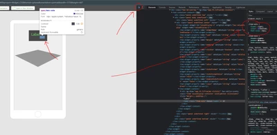

Yes you can update this as well via leveraging CSS by overriding the default CSS class behind the widget. First to figure out what class you need to override in a preview browser tab enable dev tools and use the inspect element feature and highlight/click the desired html component:
From here you are able to identify that the gray "Value" text is styled via the .item-note CSS class, so you can override this class in the same application CSS area as your custom class definitions. My CSS code looks like this:
