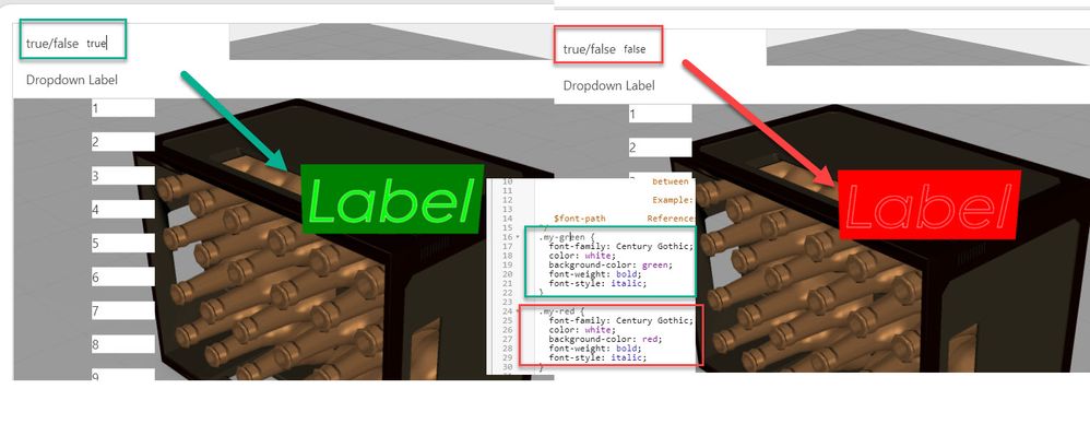

What I meant was something like this:
But to be sure if it work I tested it and  work only one time but as you mentioned it will not update:
It seems  that this will in generally not work for the frontColor of the 3DLabel widget. The property will not update when we change the value. For all properties such should update the color. I have no Idea why this not work here
As workaround/solution you can define a css style  and used it to change the apperance of the 3D label widget:
So, here I defined in the Application section /app.scss the following classes:
.my-green {
  font-family: Century Gothic;
  color: white;
  background-color: green;
  font-weight: bold;
  font-style: italic;
.my-red {
  color: white;
  background-color: red;
  font-weight: bold;
  font-style: italic;
I used here a button classes /not optimal but should only demonstrate the issue
And your code was updated to :
$scope.$watch('app.params.isOnTarget', function(val) {
	switch (val) {
        case "true":
        //$scope.setWidgetProp('3DLabel-2','fontColor','green');
        $scope.setWidgetProp('3DLabel-2','class','my-green');
        break;
      	case "false":
        //$scope.setWidgetProp('3DLabel-2','fontColor','red');
        $scope.setWidgetProp('3DLabel-2','class','my-red');
        break;
	$scope.$applyAsync();
