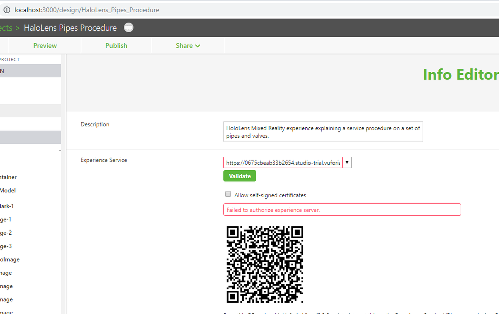

For some reason I am not able to validate the experience service and publish my experience in Vuforia Studio.
Any ideas?
See below.
I would appreciate some help.
Bill

Hello Bill,
First thing to check, does the Experience Service is running or reachable ?
For that, in your web browser, run this URL :
https://<Your Experience Service URL>/ExperienceService/ping
Second thing to check for a trial instance, does this instance is not shutdown or decommisioned.
Can you give your email address used to have this trial, please ?

Hi Samuel,
Thanks for your help.
I ran the URL. See Result below. It says "OK."
My email address is: bdrosos@boundarysys.com
So, the Experience Service is running.
A second quick test can be done.
In Chrome web browser when using this URL https://0675cbeab33b2654.studio-trial.vuforia.io/ExperienceService/ui
I have done it and the result reported is :
{"message":"Inactive tenant","errorCode":"","error":{"status":404}}
In my trial Experience Service, I have a credential popup.
So, I suppose that this instance has an issue.
I am looking that with R&D and I will come back to you.

Samuel,
Thank you.
I think that my Vuforia trial may have expired and caused this issue.
The company I work for, Boundary Systems, is a PTC reseller.
Would I be able to get the licensed version?
Bill
Hello Bill,
Yes, the feedback of R&D confirms that too.
They are looking to restart it and extend the trial time.

Hello Bill,
R&D has extended this trial instance.
Also, you have been registered as a partner now with this instance.
In a such case, the trial will not expire again automatically.
