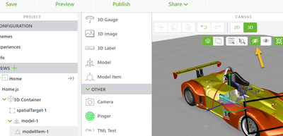

Hi Everyone,
Can anyone tell me how to drop modelItems on to the parts that are inside an assembly in Vuforia Studio
that is the part is not visible directly.
Thanks in Advance
You can use the hide icon to hide selected item (basically turn on icon and click 3D model ) and then drag a model item onto the exposed model

Hi @sgreywilson
Good Morning,
It did work thank you for the solution.
you can also zoom in inside the model considering part is visible on which you want to drop model item and apply model item to that. just try this it will work.
