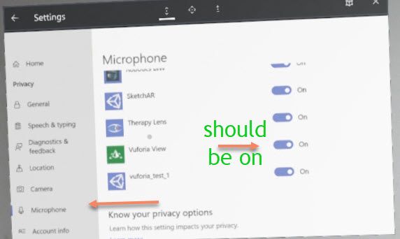

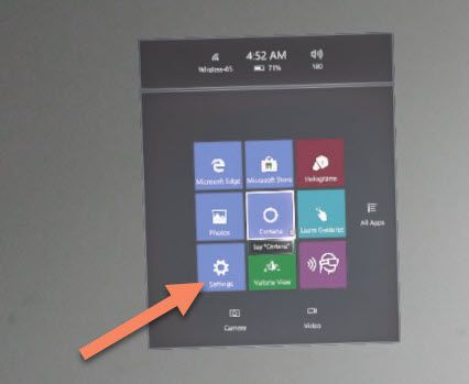

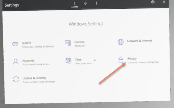

Did you check in the HoloLens setting privacy if the microphone permission is allowed for the Vuforia View app?
Following steps:
