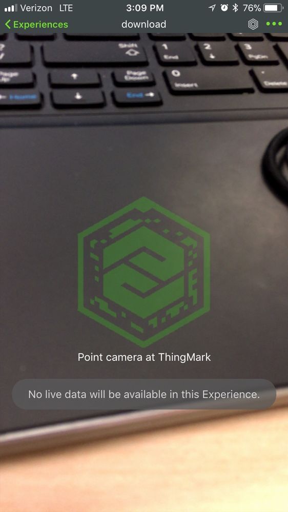

Downloaded experiences are meant for offline use as all content is local to your device. No external calls are being made to the Experience Service or ThingWorx while viewing a downloaded experience. After opening a downloaded experience, a message is displayed briefly noting that live data will not be available.
