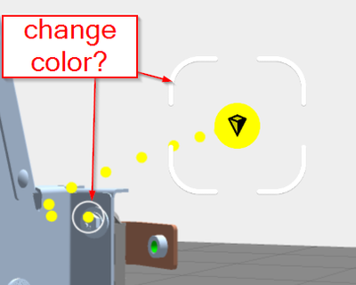

Hi Community
Is there a way to change the color of the reticle and the circle of the Wayfinder widget?
Thanks for your help!
Best wishes
Alex

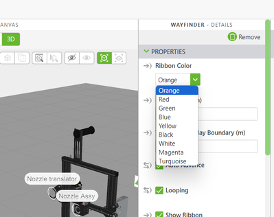

Thanks for your reply. I want to change the white color of the reticle and the circle, not the ribbon.
Best wishes
Alex
