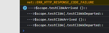

What I observed was that the arrived event was working fine but the departed event does not fire (at leaset in preview mode).

Anyway, I've noticed that the departed event happens only when reaching the last point, see the picture.
I also played with the next/prev buttons and only when arriving and leaving to the last POI it fires the departed event.

Hi @AndreaT ,
thanks for the feedback about the departed event. Yes, it was based on the autoAdvance property setting. So when I did set it I will have this event fired.
And I think in the current functionality the behavior intended when autoAdvance property set.
So Auto Advance property will cause that when we arrive (distance inside the radius value) to a waypoint then the arrived event is fired and also then the next service is called. Therefore the departure will not fire any more. I checked when we go back to the old (previous) point in this case it will not fire the arrived event any more for this item. so In this case seem only the new(next point) point is relevant (this could be changed when we call the previous service). And when we arrive to the next waypoint then it will immediately fire the arrived event by following of the next service
So if we want a different behavior we can unset the Auto advance property and e.g. then call the next service e.g. from the departed event.
