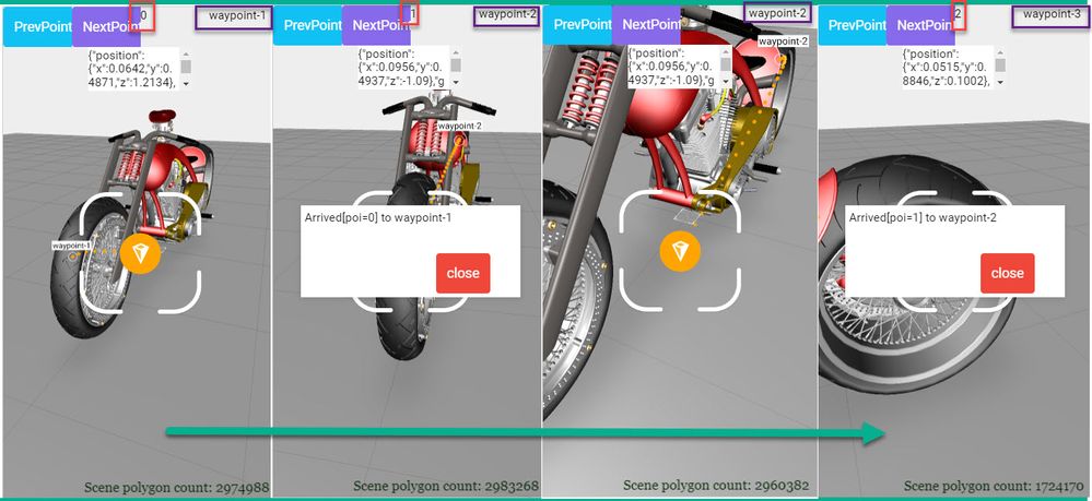

Hi @AndreaT ,
I would suggest to use the Wayfinder widget propeties $scope.app.view['YourViewName'].wdg['YourWayfinderWdg']['selectedWaypointValue'] so example what it could contain e.g. for Waypoint-1:
{"rows":[{"position":{"x":0.0642,"y":0.4871,"z":1.2134},"gaze":{"x":0,"y":0,"z":1},"up":{"x":0,"y":1,"z":0},"eventRadius":"0.8","wayfinderDisplayBoundary":"0.4","label":"waypoint-1"}],"dataShape":{"fieldDefinitions":{"gaze":{"aspects":{},"baseType":"STRING","name":"gaze"},"position":{"aspects":{},"baseType":"STRING","name":"position"},"up":{"aspects":{},"baseType":"STRING","name":"up"},"metadata":{"aspects":{},"baseType":"STRING","name":"metadata"},"label":{"aspects":{},"baseType":"STRING","name":"label"}}}}
and
$scope.app.view['YourViewName'].wdg['YourWayfinderWdg']['poi']  which a number starting by 0 no waypoint was found and counting then the waypoints
You could define also callbacks where you can check the values and then start the desired actions here example
and the sample js code for it:
let DEBUG=false
$scope.testClbkArrived = function(text) {
 console.log("--->$scope.testClbkArrived ()::");
for (var  i= 0; i < arguments.length; i++)
   {if(DEBUG)console.log('Argument ['+i+']='+arguments[i]);}
 let WaypointValue=$scope.app.view['Home'].wdg['wayfinder-1']['selectedWaypointValue'].rows[0].label
 let Waypoi =$scope.app.view['Home'].wdg['wayfinder-1']['poi']
 //arrived  ... you can add there your code when you arrived - e.g. make something visible e.g. below
   $scope.setWidgetProp("textArea-2","text","Arrived[poi="+Waypoi+"] to "+WaypointValue);
  $timeout($scope.$root.$broadcast('app.view["Home"].wdg["popup-1"].svc.showpopup'),100);
$scope.testClbkDeparted = function(text) {
  console.log("--->$scope.testClbk(.testClbkkDeparted::");
  {//departed ... you can add there your code when you departed - e.g. make something invisible

Anyway, I've noticed that the departed event happens only when reaching the last point, see the picture.
I also played with the next/prev buttons and only when arriving and leaving to the last POI it fires the departed event.

Hi @AndreaT,
I did not test it fully, but I can give you some quick feedback. Yes, from what I can see in @RolandRaytchev original code, we did change some of the property names for the final release:
'selectedWaypointValue' is now 'selectedWaypointData'
'poi' is now 'selectedWaypointIndex'
To see all of the current property names, please see the Help Center  http://support.ptc.com/help/vuforia/studio/en/#page/Studio_Help_Center%2FWidgetWayfinder.html%23
Try switching out those two property names and see if it works again.

Hi @AndreaT ,
yes in the regular release it seems to  be a change of data structure  The structure  of the point data itself is now more simplified , but - unfortunately the way I handled it before is not working any more. Also it seem now that is not possible directly to extract  the data inside the binding filter. Because we have now only the selected index as number and the data (simplified) which contains only the fields. Here example
{"widgetName":"wayfinder-1","selectedWaypointIndex":"0","waypointsData":[{"position":{"x":-0.3336,"y":0.4732,"z":-0.2543},"gaze":{"x":0,"y":0,"z":-1},"up":{"x":0,"y":1,"z":0},"eventRadius":"0.1","wayfinderDisplayBoundary":"0.1","label":"Waypoint 1"},{"position":{"x":0.0608,"y":0.4892,"z":0},"gaze":{"x":0,"y":0,"z":-1},"up":{"x":0,"y":1,"z":0},"eventRadius":"0.1","wayfinderDisplayBoundary":"0.1","label":"Waypoint 2"},{"position":{"x":0.5117,"y":0.6721,"z":-0.3123},"gaze":{"x":0,"y":0,"z":-1},"up":{"x":0,"y":1,"z":0},"eventRadius":"0.1","wayfinderDisplayBoundary":"0.1","label":"Waypoint 3"},{"position":{"x":-0.1058,"y":0.6174,"z":0.1117},"gaze":{"x":0,"y":0,"z":-1},"up":{"x":0,"y":1,"z":0},"eventRadius":"0.1","wayfinderDisplayBoundary":"0.1","label":"Waypoint 4"},{"position":{"x":-0.1467,"y":0.1608,"z":0.1022},"gaze":{"x":-5.781425897883269e-17,"y":0.47208925070547064,"z":0.8815507582484104},"up":{"x":0,"y":1,"z":0},"eventRadius":"0.1","wayfinderDisplayBoundary":"0.1","label":"Waypoint 5"}],"showReticle":true,"enabled":true,"labelsOnTop":true,"showLabels":true,"showWaypoints":true,"showRibbon":true,"looping":false,"autoAdvance":true,"wayfinderDisplayBoundary":1,"eventRadius":0.25,"ribbonColor":"#FFA500","reticleVisible":true}
Thefore now to get the correct waypoint e.g. the waypoint number we need to use the selectedWaypointIndex and extract from the array the dataset e.g:
 let WaypointSelectedIndex=parseInt($scope.app.view['Home'].wdg['wayfinder-1']['selectedWaypointIndex'] )
 let WaypointValue=$scope.app.view['Home'].wdg['wayfinder-1']['waypointsData'][WaypointSelectedIndex].label
 let Waypoi =$scope.app.view['Home'].wdg['wayfinder-1']['waypointsData'][WaypointSelectedIndex]
   $scope.setWidgetProp("textArea-2","text","Arrived[indx="+WaypointSelectedIndex+"] to "+JSON.stringify(WaypointValue));
I adapted the previous project to the new functionally and attached it now here (please, pay attention that I did only fast check - not sure if there are some issues but so far I tested it worked. Let me know if you find any issues , I will check it more detailed. Thanks
